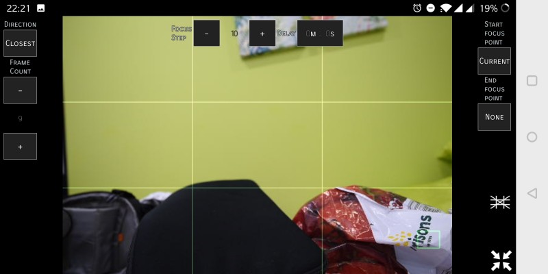

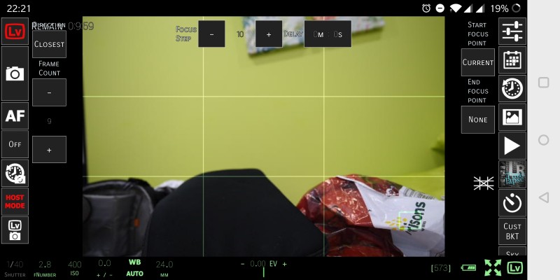

I am connecting my camera Nikon D810 to my smartphone (OnePlus 5T running on Android 9). When I open the focus stack screen on qDslrDashboard, I can neither see focus ponts 1 and 2 as mentioned in manual, nor do I see focus forward/backward buttons. If I touch the screen, auto focus works fine, but I can't save it to points 1 or 2 and hence can't use focus stack at all! I have tried connecting to camera via both USB-OTG and wireless (TP-LINK MR3040), but those points/controls are not visible. Please help!

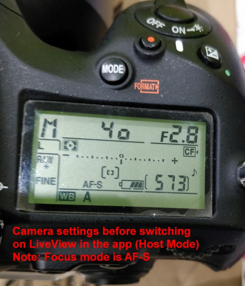

Thanks for your response. But the focus mode is already AF-S and set to automatic (as I mentioned earlier, the auto-focusing in the app works fine when I touch the screen. Please find screenshots of app and my camera settings attached. You can see the autofocus green box on the app screen over "Morrisons" plastic bag in the bottom-right corner.. Please resolve this issue. Thanks

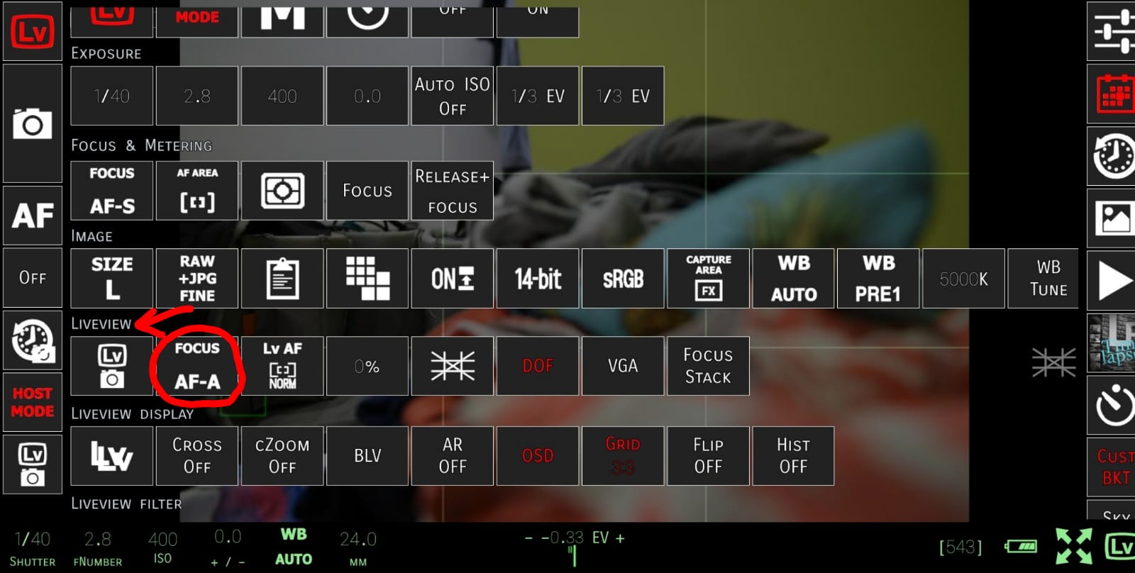

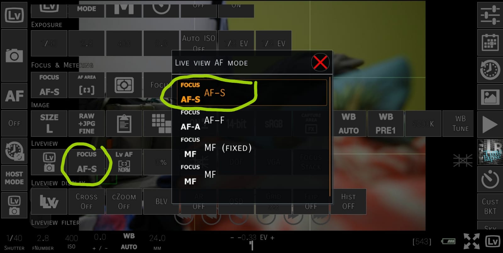

Found the issue. The settings on my Nikon were correct (AF-S + AutoFocus enabled), but had to change the focus mode in LiveView section of the qDslrDashboard app's camera settings menu. It was set to AF-A by default (red circle in screenshot). Changed it to AF-S and focus stack started working.

Incorrect:
Correct:

Yes, there is a separate focus mode property for the live view.
