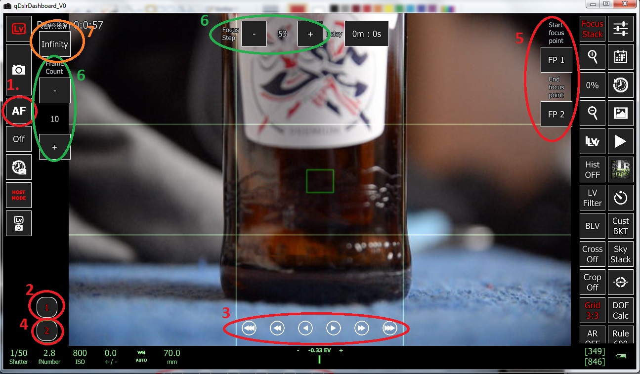

A quick tutorial for focus stacking (how I do it):
Screenshot is from older qDD version. Now to open focus stacking you need to switch UI to LV (LV button on bottom right corner) and than click "focus stacking" which is in top right corner.
Nikon:
1. Use AF (or arrows) to focus on first point.
2. Long press (1) button to remember position
* (skip to 5. if using infinity or minimal focus distance)
3. Use arrows to focus on second point (for Canon use only one size step arrows </> xor <</>> xor <<</>>>).
*Correction to previous post:
Do not touch focus ring on lens. It will cause you to set focus points from start.
4. Long press (2) button to remember 2. position
5. Set range points
6. Set number of steps or step size.
7. Set direction if necessary (should be done automatically).
7.5. (not on screenshot) On some cameras (Nikon D3x00, Nikon D5x00, maybe others) you need to add 1-3s delay so it won't hang in middle of capture sequence.
8. Press qDD shutter button to start capture sequence.
