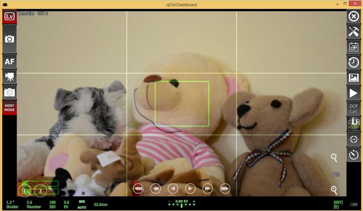

The qDslrDashboard user manual shows a +/- magnifier on the live view screen. I can't seem to get that feature. Is there something I need to turn on?
Yes, I know the magnification can be adjusted in the camera properties screen but it would be nice if it was on the live view screen.

What camera?
After entering LV there will be a small 'LV' button in the bottom right corner that you can use to toggle the right side buttons, pressing it will show the live view right side button including the +/- live view zoom button.

The D800 and D850. I found them now, thanks to your help. Not where I was expecting to find them at all. I was using the manual pdf and obviously it is older then the current 3.5.7 version.
Image from older version of DslrDashboard

This is an older version on image, I was referring to the latest one.
