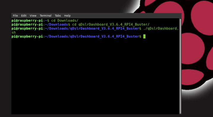

I tried it on a non-Raspbarry Pi ARM Linux (Ubuntu 22.04 XFCE as a QEMU VM on a Mac M1), but same issue: nothing happens when I run the start script `qDslrDashboard.sh`. Even after copying the missing libraries in the Qt_libraries folder.
Then I tried it again on a real Raspberry Pi 4 (Ubuntu 20.04 LTS) but the same issue occurs.
Maybe this script is not a generic arm64 Linux script, but specifically for the Raspberry Pi OS ?
Screenshot 2022-05-08 at 11.25.10.png (108.18 KiB) Viewed 148564 times
Re: Error with qDslrDashboard V3.6.4 for Raspberry Pi 4
The Qt libraries where built with Raspbian OS, so it will only work with it.
