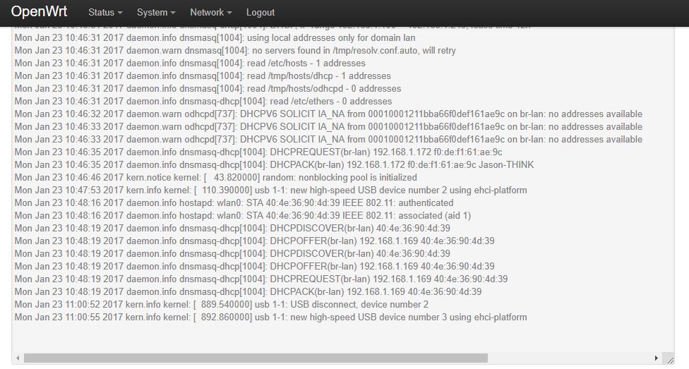

In Syslog I get the following:

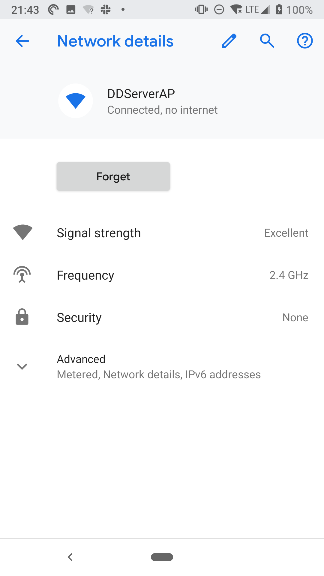

I have confirmed my Pixel 2 is connected to the network:

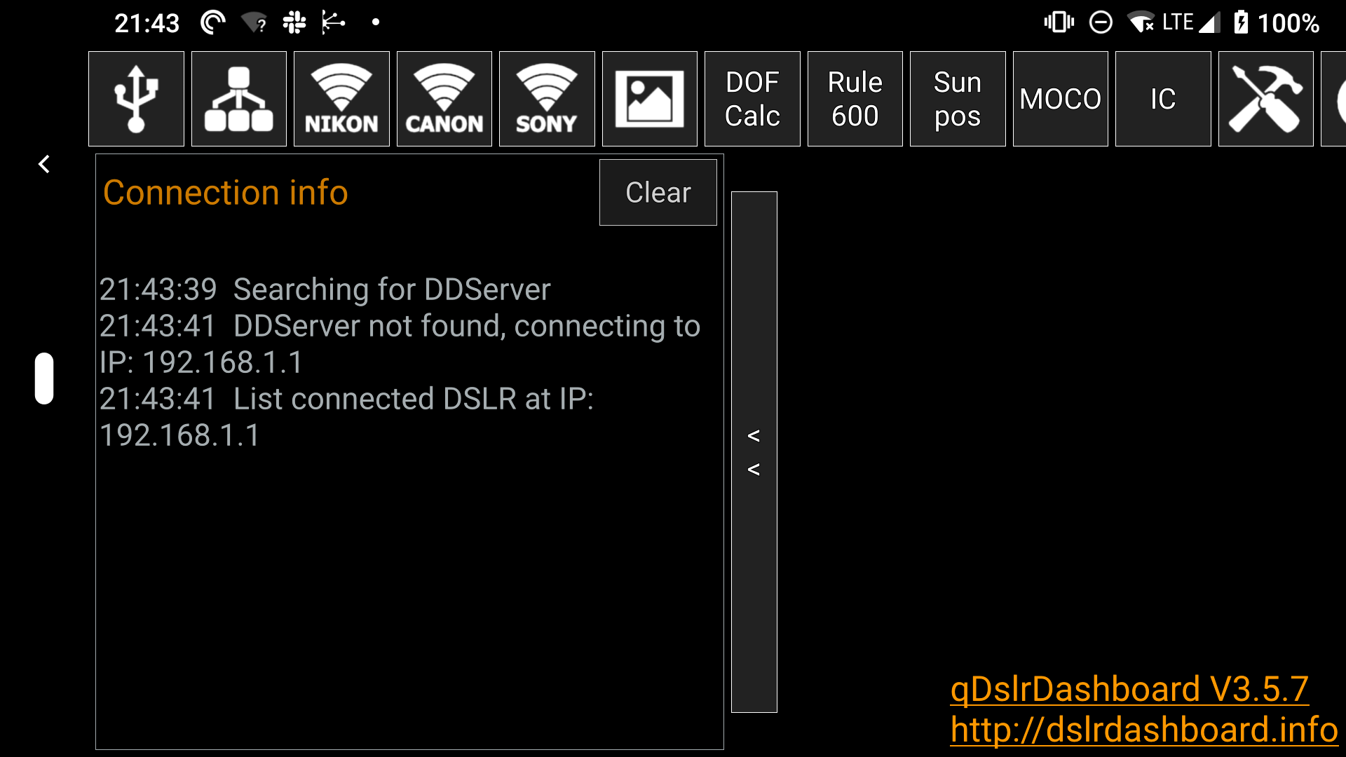

and I get the following when I attempt to connect: DDServer Not found, connecting to IP: 192.168.1.1 with no DSLRs listed on that IP
The connection re syslog seems stable, but I can't seem to get the thing connected to the camera. Any help/advice?

Try disabling mobile data on your device.
