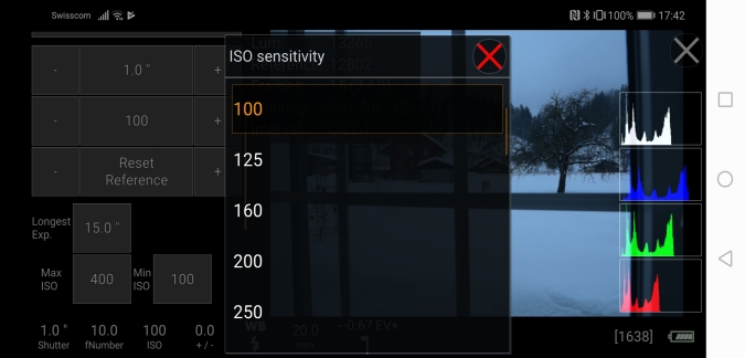

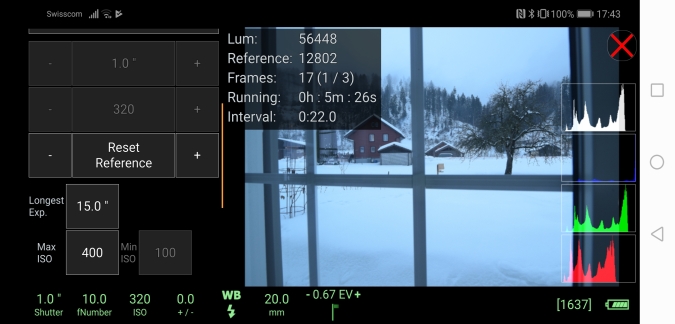

when starting a time lapse using the LRTimelapse option on the right hand side, it opens after few minutes the selection of the ISO. It looks similar when pressing on the bottom the green ISO value. As soon as the selection opened (looks like from a ghost), the ISO gets higher and higher - much more as set to the max ISO at the end of the time lapse. That happens even the before the shutter gets changed.

The interval is set to 20 sec
the time lapse starts with the above setting
after few pictures, the ISO selection opens automatically
it takes again few pictures, the ISO selection closed and the ISO value was set to 320
few minutes later, the ISO selection opens again
the same as earlier happen again - the ISO selection closed and the ISO value was set to 1'000
when the shutter reached the max. value (15 sec), the ISO selection opened again and the value was set to 400

The LRTimelapse Settings are set to:
- Avg pool size: 3 avg.
- Transfer every: 3 frame
- EV step: 0.33 EV
- Auto direct: false
- Use Aperture ramping: false
