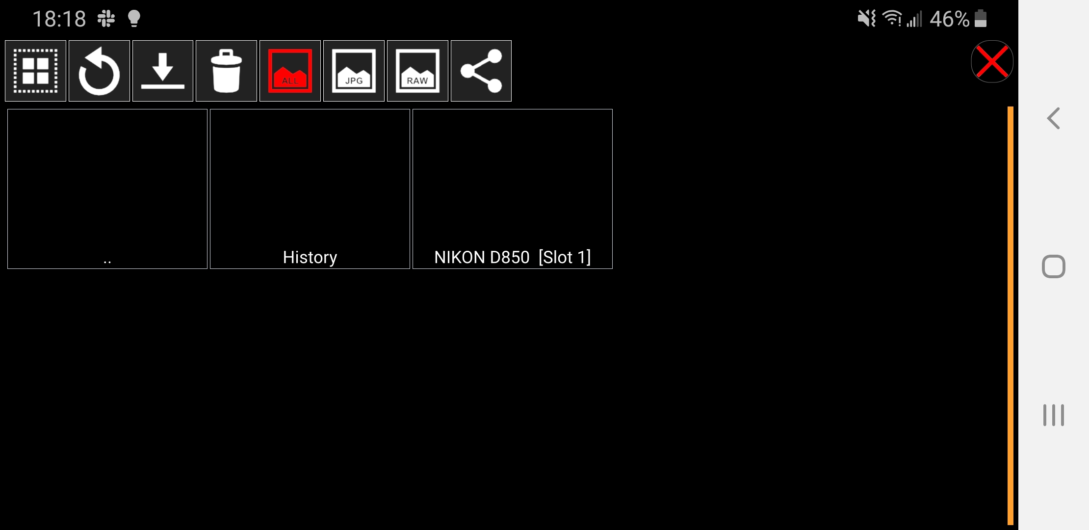

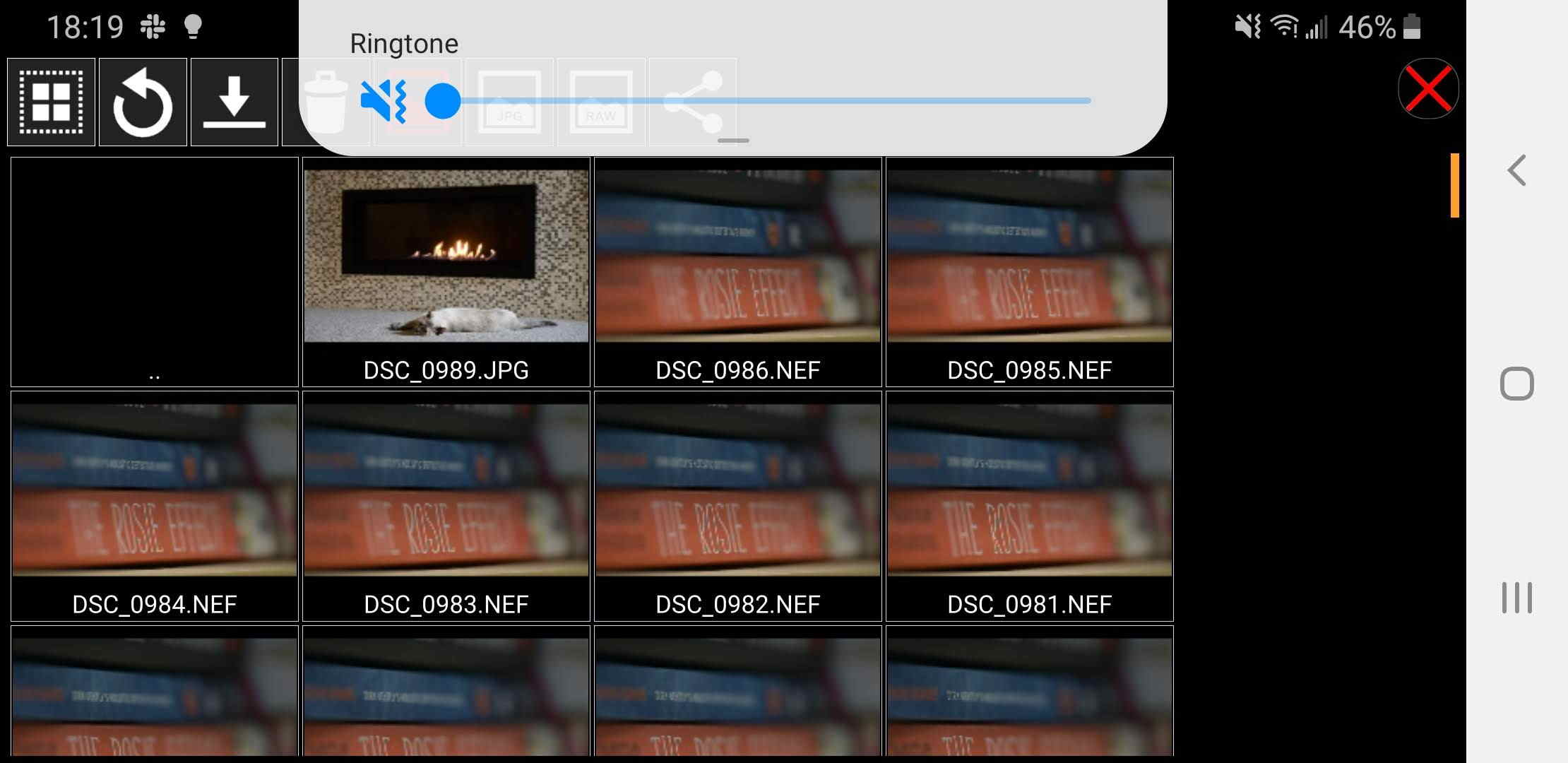

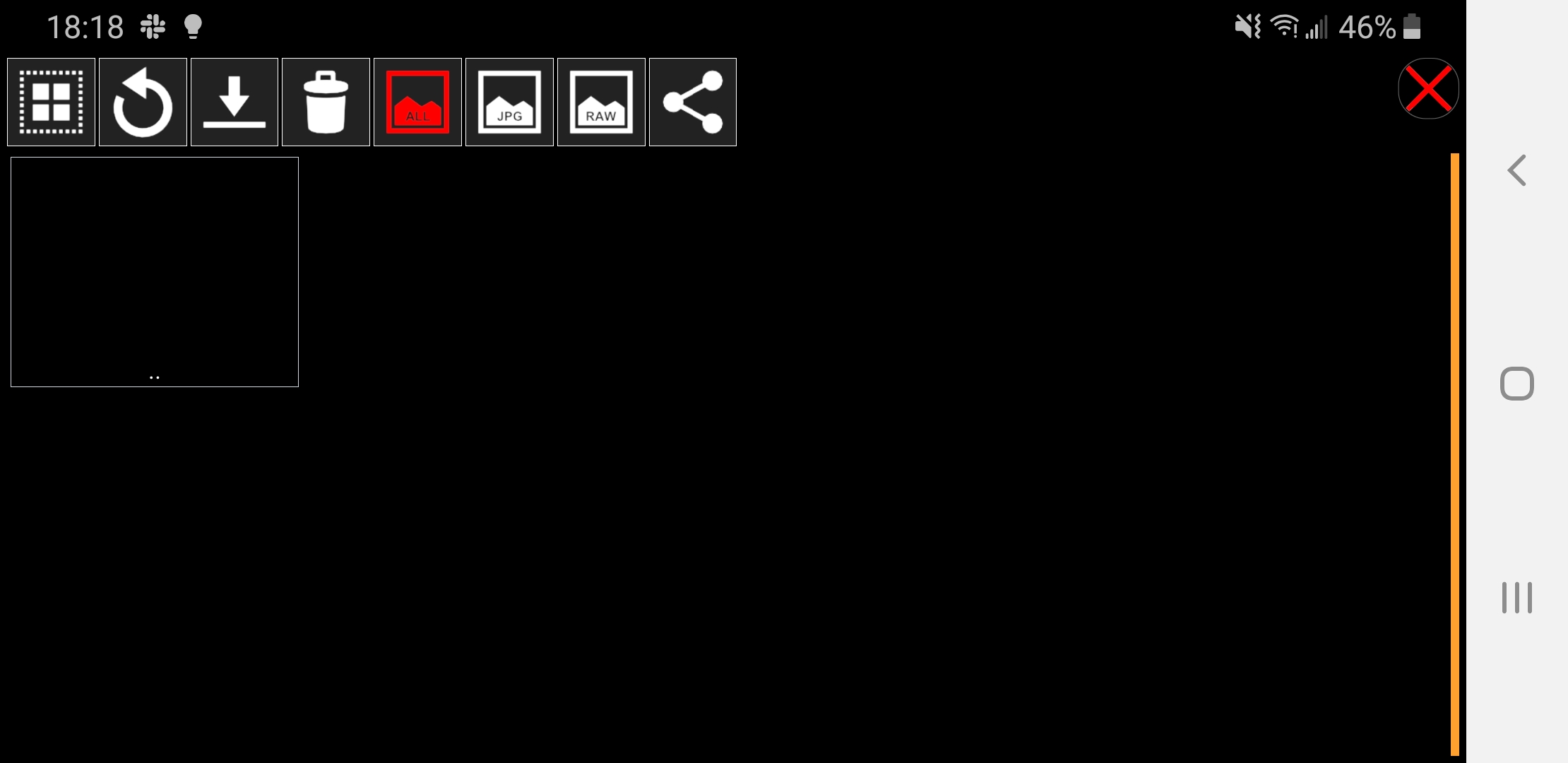

Ok I figured it out. The docs are a little out of date.
Once you are connected you press the picture button.
Instead of card slots in the toolbar the D850 slot1 appears in the main screen
Once you click on that you see nothing right away.
To see the pictures you need to press the refresh button. Then you can select the images you want to share, download then from the camera and then they are sharable.
