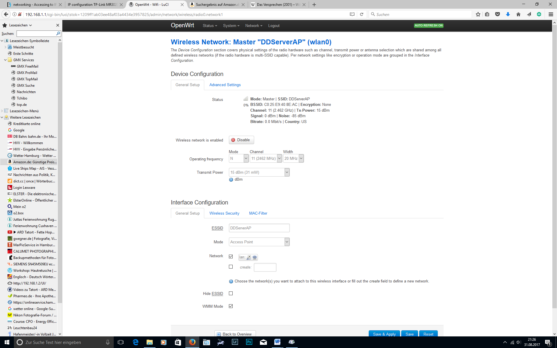

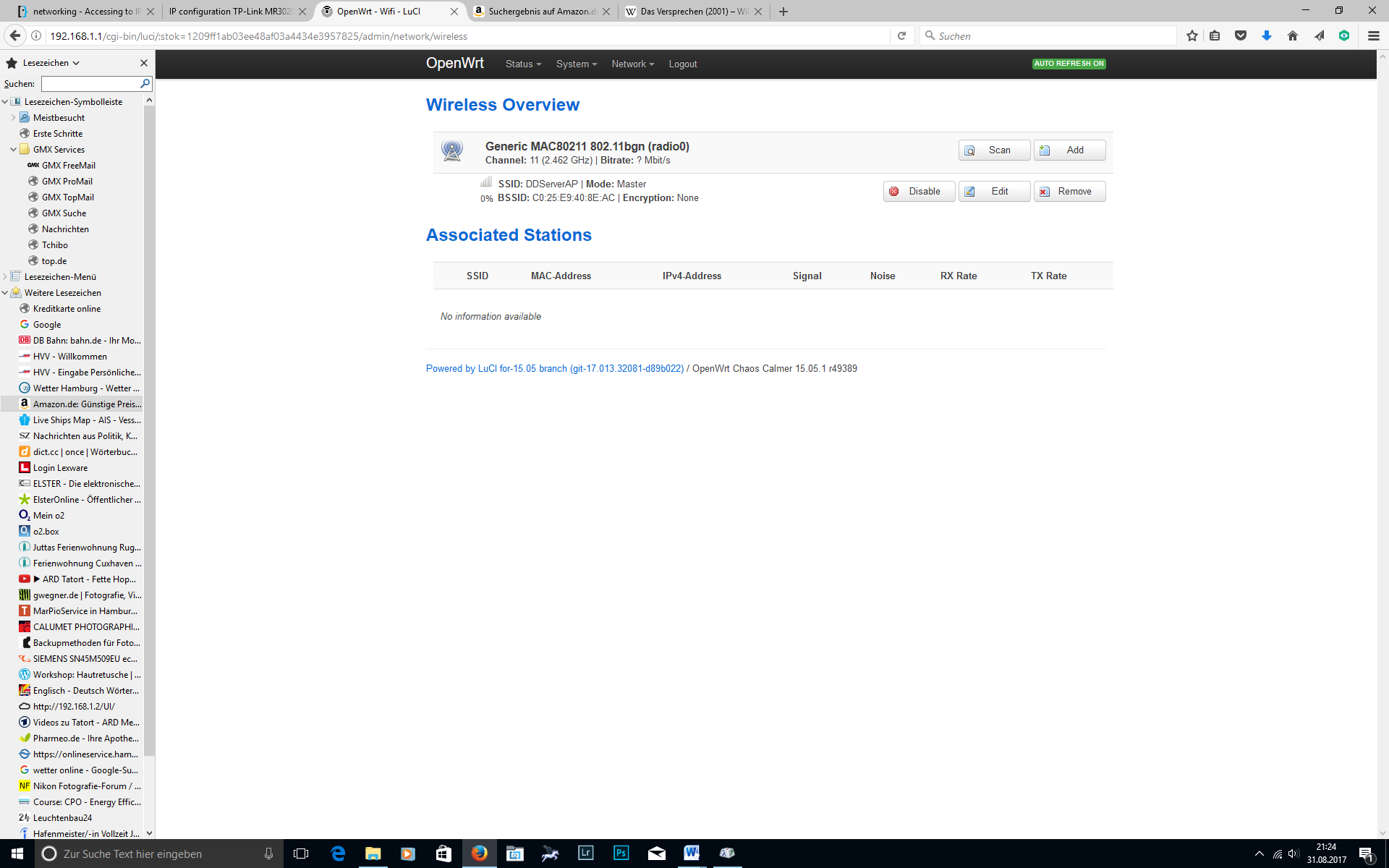

Now I reflashed like advised and did not change anything. Please find screenshots attached.

Thanks.
According the screenshots the wireless configuration is ok.
By default there is no password setup for the AP so eventually check the 'Wireless security' tab and setup encryption (i use wpa2-psk)
Eventually try changing the wireless channel under the 'Operating frequency'.
Is the 'DDServerAP' wireless AP listed on your controlling Android tablet?
If yes try connecting to it. Does it connect?
Monitor the 'Associated Stations' part, after your Android tablet connects with wireless it should be listed there.

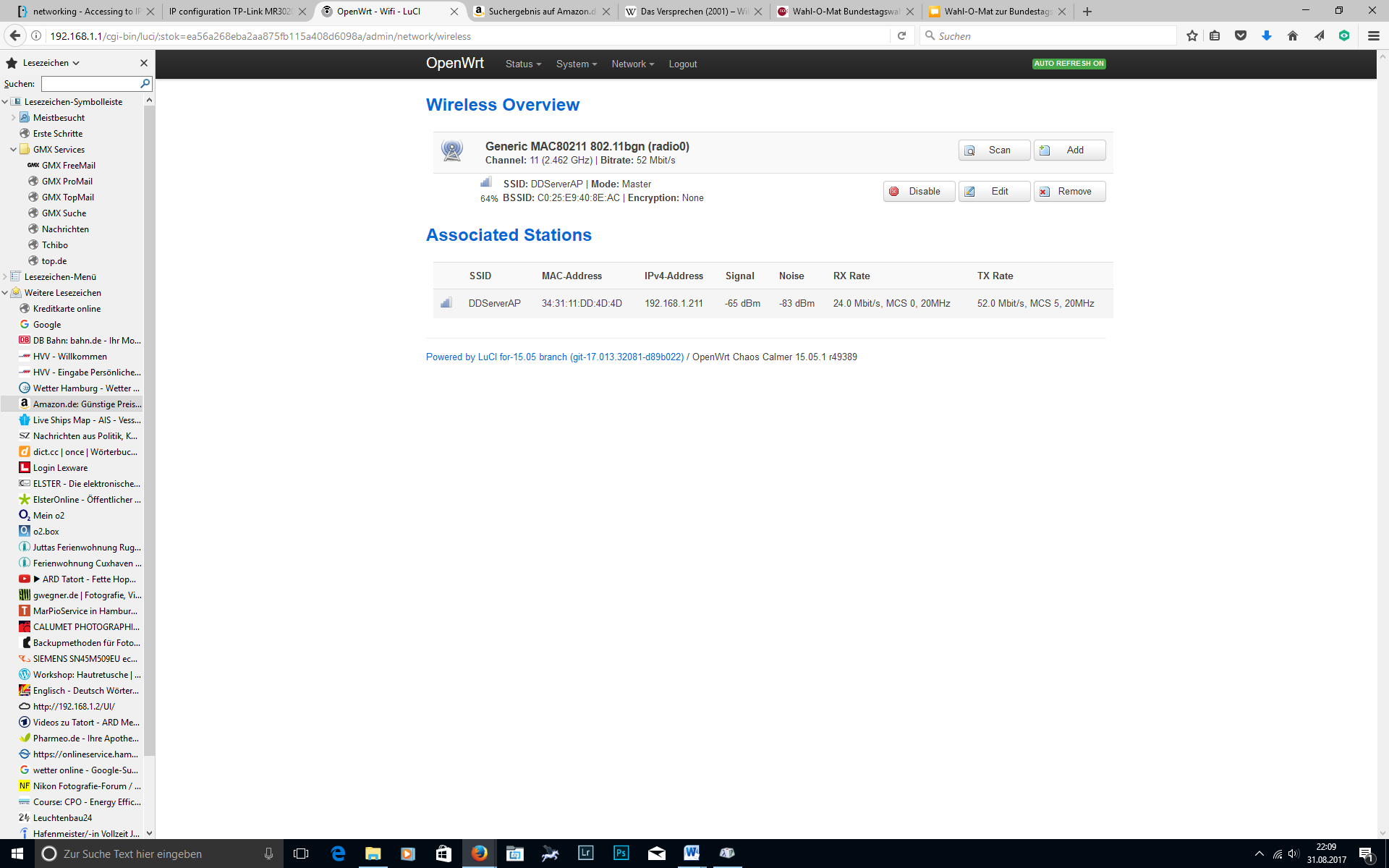

Affirmative: 'DDServer Ap' is listed on my Android Tablet, connection was established and the tablet is listed as per screenshot below
- screenshot Associated Stations.png (131.73 KiB) Viewed 31439 times

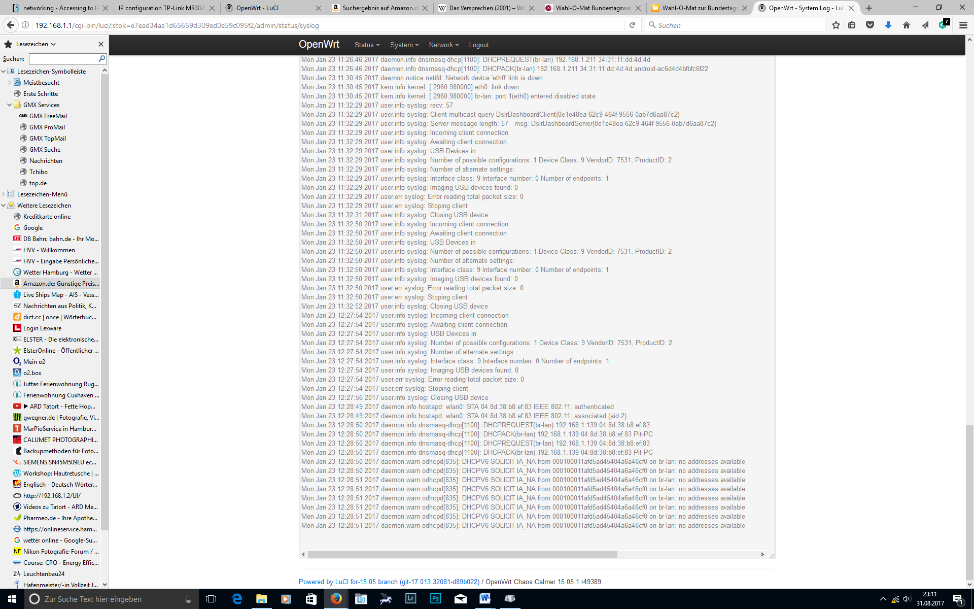

I connected DSLR to MR3020 - not recognized see system log

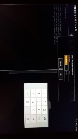

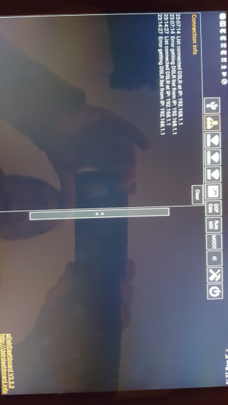

Network Button qDD showing IP 192.168.1.1 and port 4757 as shown in scrennshot
Connection not possible
- screenshot_tablet_02.png (202 KiB) Viewed 31437 times
- screenshot_tablet_01.png (170.6 KiB) Viewed 31437 times
- screenshot system_log.png (218.8 KiB) Viewed 31437 times
Re: IP configuration TP-Link MR3020
As can seen from the System Log at 11:32:29 'Client multicast query........' ddserver was found by qDslrDashboard but there where no cameras found on the USB port.
I suggest you follow this post: viewtopic.php?f=5&t=2101
by attaching your dslr to the full size USB port, turning it on and then making a screenshot of the Status->System Log output

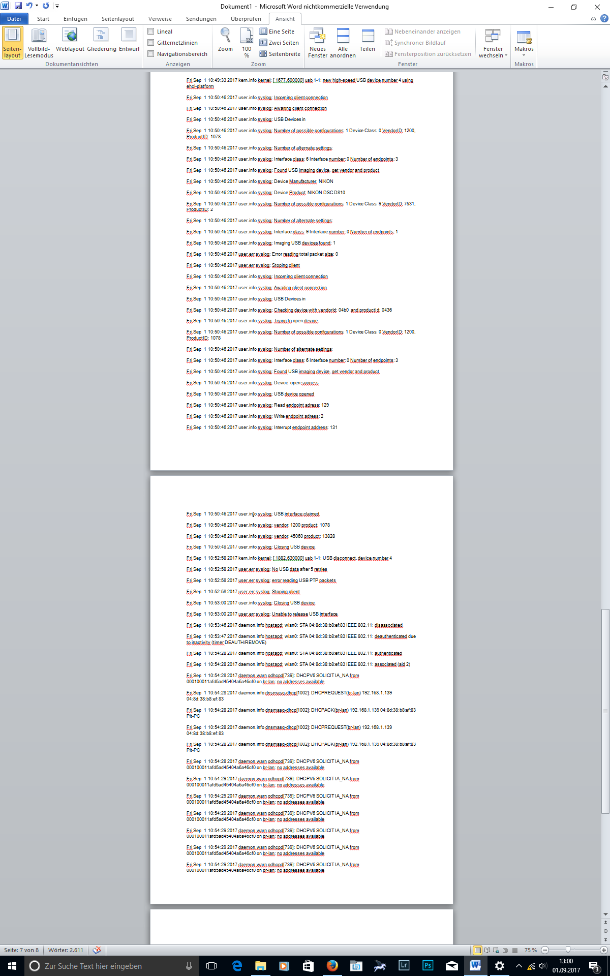

I'm very happen: could connect to my NIKON D810 and enjoyed wireless remote control via MR3020 on qDD. Just for your information I'll attach last system log.
Thanks again for your great support and your patience. Is there any way to support your project by donation or something like this?
- screenshot system_02_log.png (170.58 KiB) Viewed 31432 times
