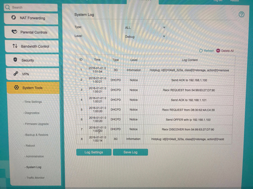

hubaiz wrote: ↑25 Jul 2019, 08:24 Maybe some screenshots?
Do you have the ddserver package on the System->Software page? (screenshot)?
The system log last 10 lines after you connect and turn on the camera with USB to MR3020?

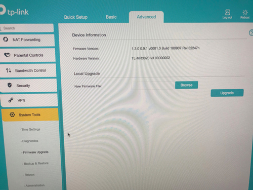

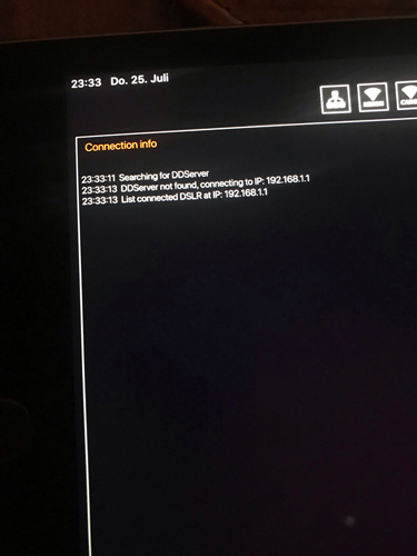

thanks, so i had a look and i think i missed it. its the "mr3020 v3". So i tried this way here from the post https://dslrdashboard.info/phpBB3/viewt ... 0+v3#p7935
but I can not get it somehow. Screenshots attached.
thx for help and support.
Jem
Re: Help runing TP Link TL-MR3040 with my Canon 5DM3
That is still the original TP-Link firmware on the device.
It will only work with the OpenWrt firmware and the ddserver package.

hubaiz wrote: ↑28 Jul 2019, 07:28 That is still the original TP-Link firmware on the device.
Yes i know, but what i am doing I tried to install like the documantation here.
How to install the ddserver package and the OpenWrt ?
Thanks 4 help
Jem
wlayher wrote: ↑05 Apr 2019, 08:22 You can't install openwrt via the web interface of the manufacturer firmware.
You have to use a tftpd server to do that.
See here: https://forum.openwrt.org/t/tp-link-mr3 ... s/10273/27
I don't have this device, so I have not tested this, but I guess from the posting in the link above that you can use the tutorial for the TP-Link TL-WR902AC AC750 v.3. You just have to change the IP address for the tftpd server mentioned in the other tutorial from "192.168.0.66" to "192.168.0.225".
Get the firmware image here (that is the same as the "factory file" mentioned in the first link above), rename it to "tp_recovery.bin" and put it in the working folder of tftpd32/64. The rest is the same as for the TP-Link TL-WR902AC AC750 v.3.
Hope this helps.
