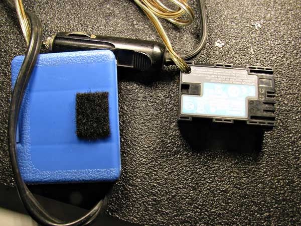

The only drawback is increased consumption of the 5D battery
I have hacked a battery with a voltage reducer so that I can plug into a jump starter battery pack. It will last for days. You can actually use any sort of battery pack.
