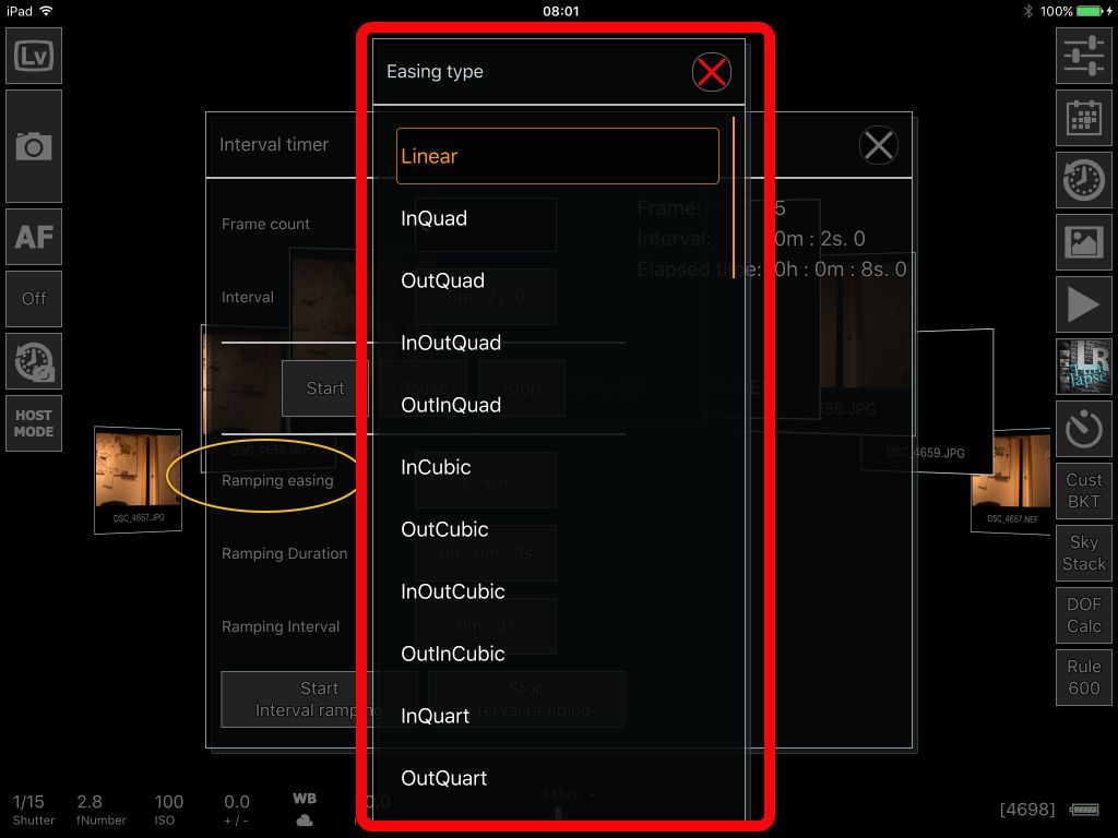

Where can I find the documentation of the function "Ramping easing" and the "Easing type"?
Have the net and your Doku looked for and unfortunately nothing found.

1. When 'Auto direction' is enabled qDslrDashboard will do the correction in both direction (sunset, sunrise).
2. 'Timer' - are you referring to the interval timer?
3. What setting isn't clear?
'When to use 'Start interval ramping' - whenever you need it.
Interval ramping will ramp the interval timer interval from one value to another value over the specified time using the specified easing.
For example:
- you started the interval timer with 5 second interval
- you setup interval ramping for 15 minute ramping and the final ramping interval to 10 seconds using the linear easing
- after you start the interval ramping it will begin to increase the interval and after 15 minutes the interval will be 10 second.
You can find the easing types here: http://doc.qt.io/qt-5/qeasingcurve.html
