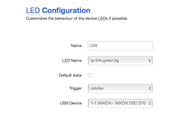

And the MR3040 knows there is a D700 attached, because the LED status page aknowledges it.

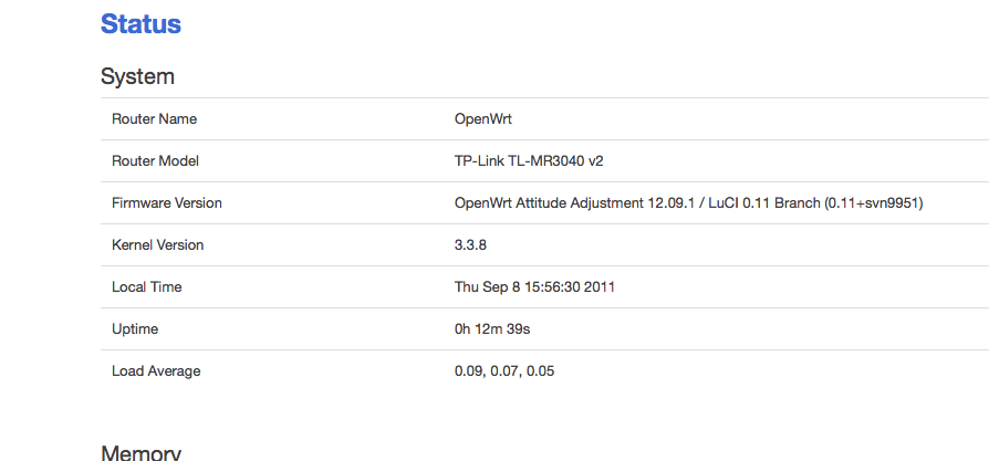

I attach the overall status screenshot too.

But curiously if I look at the LED configuration page (heh, I'm desperate...), there the camera model shows up correctly, so it has connected in some way.
I'm pretty sure I have the right firmware, but can you confirm ?
Router Name OpenWrt
Router Model TP-Link TL-MR3040 v2
Firmware Version OpenWrt Attitude Adjustment 12.09.1 / LuCI 0.11 Branch (0.11+svn9951)
Kernel Version 3.3.8
Thanks for your patience,
Mark

The firmware is ok, seams it does not recognize the camera.

And I'm really confused by it not working, as when I look at the 'system led configuration' page in OpenWrt, it names the camera correctly,
so it is identifying the camera at some level.
