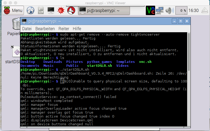

Re: Raspberry Pi VNC
Post by klettermax »
Sorry, i got the Free License from RealVNC. But the issue is the same :-(
I See the Windows qDD on the Pi but not in VNC.
Bildschirmfoto 2016-03-30 um 18.30.11.png (130.49 KiB) Viewed 25708 times
So it looks like it won't work.
