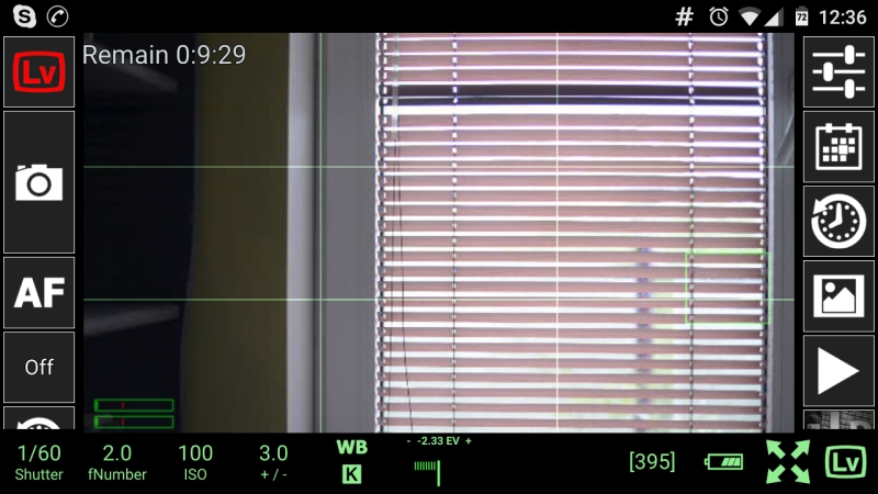

This is what I see. No buttons or arrows to move the focus point manually.
- qDslrDashboard.jpg (178.58 KiB) Viewed 27337 times
Re: How to switch off auto focus?
You must set your focus mode to AF-S.
Also set UI to much smaller. With this size buttons won't fit on screeen.
Thanks for the tips! I'll try them later when I get home.
How do you set the UI smaller? The device is Samsung Galaxy S3 btw, so the UI is actually not very big in physical means.
