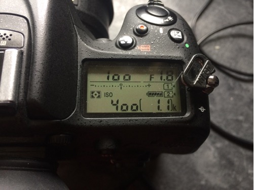

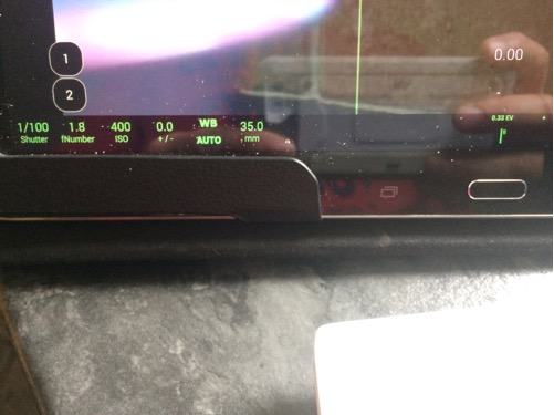

Just noticed that the qdslrdasboard doesn't show the correct exposure when connected. Please see photos attached. As you can see te camera is showing a correct exposure but on the second one the qdslrdasboard is over exposes by +.33
I have a D7200, lates qdslrdasboard version and latest ddserver on the tp link mr 3040.

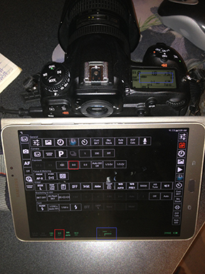

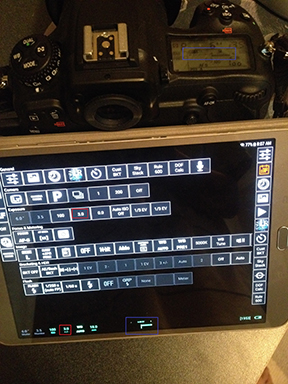

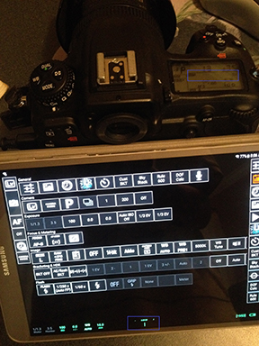

Re: Wrong exposure on qdslrdashboard app
Posted: 30 Jun 2017, 15:03
by dslr
sorry if it's difficult to see...may need to download and zoom to see the details...
changes to EV values were made using qdd only...
blue boxes - no exposure bar on camera...value 0 on qdd green exposure bar
red boxes - non-zero EV values (+3) on camera and qdd
blue boxes - exposure bar on camera (overexposure)...non-zero value on qdd (overexposure)
red boxes - EV value set to 0...both EV values are refreshed/updated to 0
blue boxes - no exposure bar on camera yet qdd is not 0 like image 1, ie same non-zero value on qdd, not refreshed/updated
exit qdd then restart forces it to refresh everything...qdd will show 0 on its exposure bar
