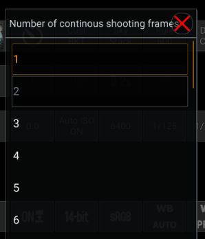

keep an eye on the camera/host mode icon...when the shot is triggered, it actually switches from camera to host to issue the command then switches back to camera...also, the number of shots fired is indepedent of sky stacking (and camera/host mode)...
background -
on the camera - when BKT is on, eg set to 3 shots, and even with Cl (continuous low) or Ch (continous high) set, when the camera shutter release is pressed 'normally', only 1 shot is fired...for all 3 shots to be fired, the shutter release needs to be pressed and hold till the series is done
on qdd - the same concept applies...by default, when the shutter release 'camera' icon is tapped, only 1 shot is fired...in the camera properties, set the number of continuous shooting frames to be the same as the number of shots in the BKT series...then each time the camera is triggered, the number of shots in the BKT series will be taken, ie it's equivalent to press and hold the shutter release

You are right, 'Continuous Shooting' != 'Bracketing', but in order the camera to take 3 or more images (that are set for bracketing) you must enable 'continuous capture' so that the camera does it automatically or you can do it manually by pressing the capture button.
Space_Cowboy wrote: ↑22 Aug 2017, 23:45 It sounds like dslrdashboard need to emulate the shutter button being continuously held down for bracketing shots.
qDslrDashboard does not need and does not emulate anything, qDslrDashboard only sends the command to the camera and the camera executes it. As I already wrote you can instruct the camera to do it automatically by enabling 'continuous capture' or you can do it manually by pressing 3 or more times the capture button.
