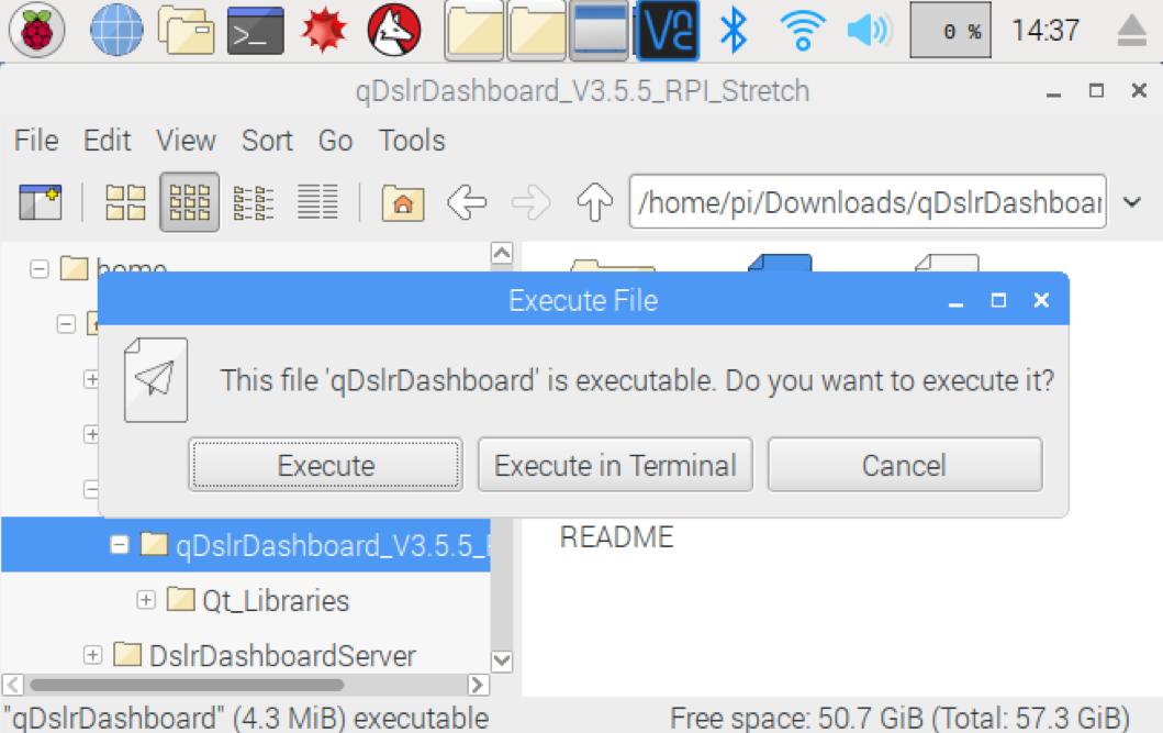

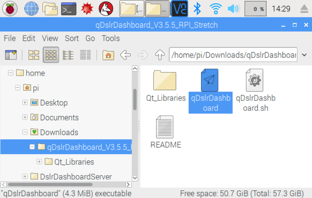

On my Raspberry 3, I have installed Raspbian Stretch and downloaded V.3.5.5. FOR RASPBIAN STRETCH. When I double-click on "qDslrDashboard" or "qDslrDashboard.sh", a window "Execute File" appears, but when I then press "Execute", nothing happens. How can I properly install and start qDslrDashboard?

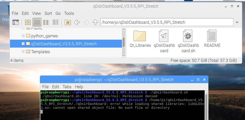

Thanks for your answer, but when I run './qDslrDashboard.sh' in the terminal, I get an error permission denied, No such file or directory.

@hubaiz: thank you for your answer. I've done all steps mentioned in your suggested post. However, the program does not start, I get the following output in the terminal. I'm connected via VNC to my Raspberry 3 since I don't have a monitor. Any idea what causes this issue?
Re: Install qDrslDashboard on Raspbian Stretch
Posted: 22 Feb 2018, 16:27
It will not work with VNC as it can't transmit OpenGL as far I know.
