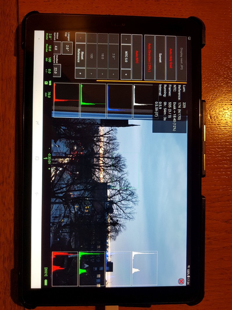

I am using NTC in the lrtimelapse screen. As I learned in a tutorial of Gunther a NTC of two will bring down the reference value during dusk to the half of the initial value ( I had a value of 132 using only a Region of the whole picture. I switched the NTC to 3.0 and started the Holy grail (sunset) with NTC. The new night reference value was then 88. After my calculation it should be a third of 132, that means 44 but NTC only subtracted 44. Am I wrong with my calculation? What can I do to bring the reference value much further down?

What do you mean? on the 'button' is shown NTC 3.0

At first (I started the program an hour befor sunset) it showed the correct sunset time for my location, then it showed dusk an the end of dusk and finally it showed Night and -> 6.27 what means our actual time where the sun will be about 12 degrees under horizon tomorrow morning,the begin of the nautical twilight

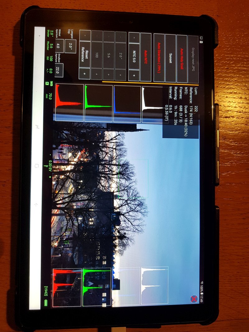

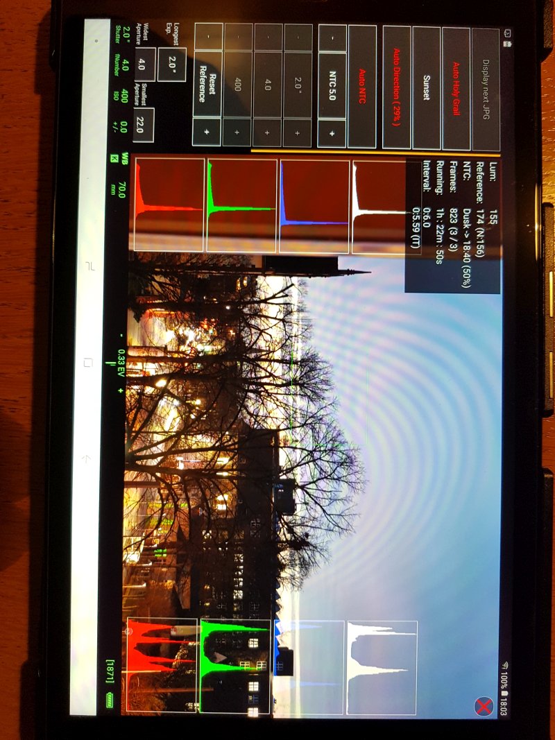

I did just another test today with NTC 5.0 . I send some screenshots to visualize
Re: using NTC in the timelapse screen
In case of a higher NTC value (3,0 or 5,0 you used) the NTC reference will be closer to the original reference.
To have a smaller NTC reference you need to use a smaller NTC value like 1,5
