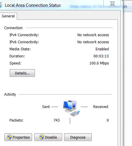

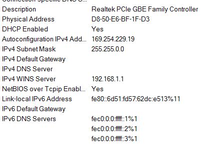

Hi, Ok this is what I have.
Connection Status.JPG (35.17 KiB) Viewed 21131 times
Unable to Connect.JPG (16.28 KiB) Viewed 21131 times
Also have the 3040 in AP as stated on the video.
Have tried setting manualy again as in the video.
Re: New TP 30-40 not seen on computer
Does your PC maybe have 2 network ports?
Do you see the light on the network port when you connect your PC with the MR3040?
Is the network adapter maybe set for connection sharing?

Hi, No 2 ports.
No light when connected 3040 but yes when the Home router connected, it flashes at the connection on computer.
Connection sharing no, only router used as wireless to other system but tried with that router turned off.
Wondering if it is the cable that is faulty will try another later.
Thank you for the help.
Russ
