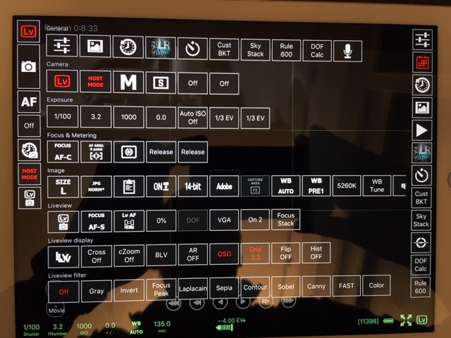

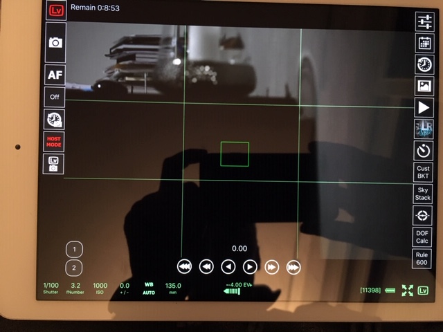

Hope these are the once you are asking for - and they can help solving the issue
Many thanks Berthold

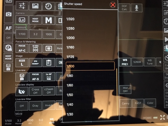

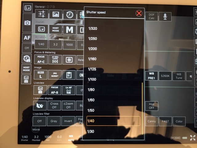

Berthold1959
Joined: 25 Feb 2019, 11:16
Re: qdslr diffenent option using similar equipment D850 Ipad
Post by Berthold1959 »
ups, one more screen
if you need specific ones, please let me know
While the live view is not activated and still connected to the camera try and change the shutter speed on the camera.
Can you go below 1/30 on camera?
I couldn't reproduce it on D7100, D500 and Z6. I only get this when I activate movie live view.
Did you both try with the same D850? I mean your friends iPad with the D850 works good and then your iPad with the same D850 is not allowing shutter speed under 1/30?
Or did you try with friends iPad and friends D850 and then with your iPad and with your D850?

:-) Switching off the LV gives me the options to change the shutter speed to below 1/30 .. :)
Will try the other settings when I meet up with my friend next time.
Thanks for your great support.
