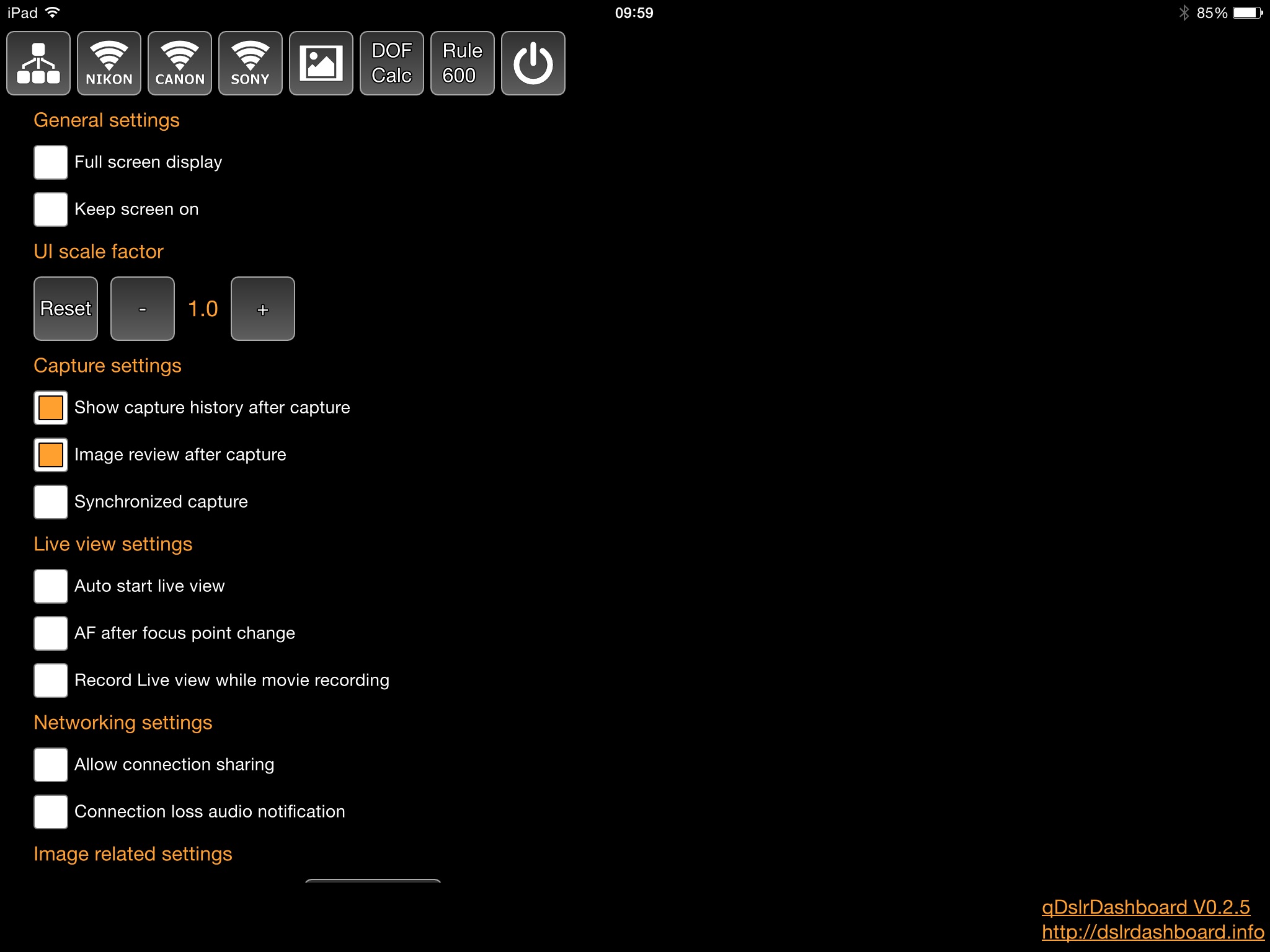

Hi there,
I'm using the TP-Link & Canon 7D.
The iPad app will work for a short while but crashes after using the lrtimelapse. When I restart the application all the controls on the right side vanish. The only solution I've found is to remove the app and reinstall.
Is there something I am doing wrong?
Thanks,
Marco
IOS Crashing
IOS Crashing
- image.jpg (205.25 KiB) Viewed 46642 times
