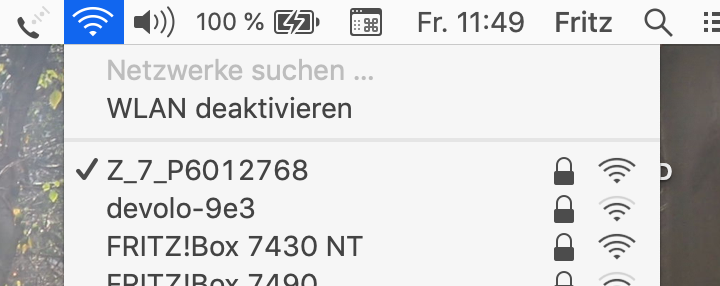

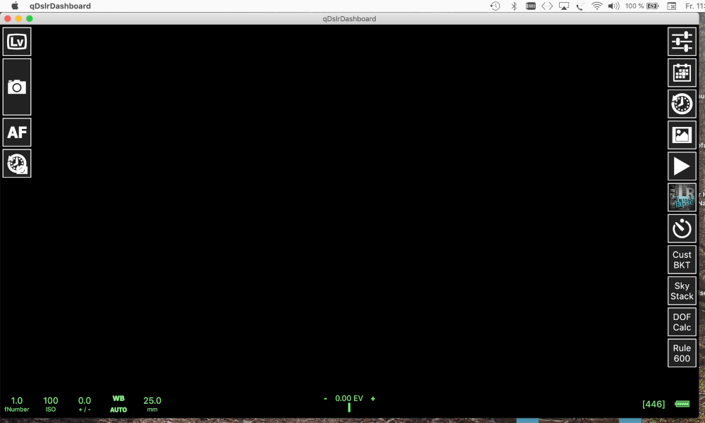

The new Nikon Z7 does not work with Wifi on OS X and Ios as well.
see attachments
USB on OS x with the Z7 works fine.
Can you please help?

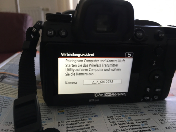

Unfortunately there are some options to start wifi on the Z7 (I assume the same is valid for the Z6). :?
The correct way (this works in my case) is the following:
In both cases (ios and os x as well) select "connect to smart device" not to computer
Then dslrdashboard and ConrollMyCamera work as expected.
fritz
Re: Problem with Niko Z7 and WiFi
Yes correct, for wireless connection you should always use the 'Connect to smart device' option.
