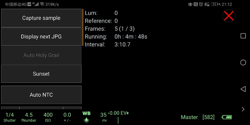

I did connect the camera to my Mate 10 according to your instructions, but after clicking “Capture Sample”, the preview shot still does not appear.
Re: Z7 can't get Auto Holy Grail
Posted: 17 Jul 2019, 20:40
I don't see the attached images.
Posted: 18 Jul 2019, 01:19
by flyman

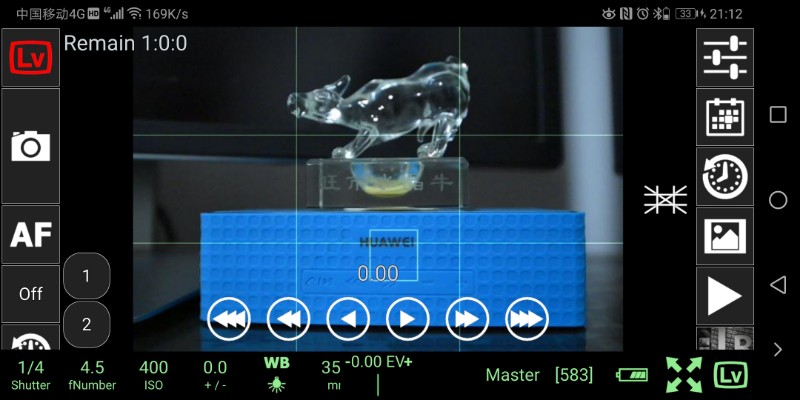

Posted: 18 Jul 2019, 05:11
What are the camera settings, can you make a screenshot of that to (second button from top on right side)
You can scale the UI in qDslrDashboard settings with the 'UI scale factor' controls.
Posted: 18 Jul 2019, 12:33
by flyman
My camera setting.
Posted: 18 Jul 2019, 19:25
by Mjj
as far as I understand the problem, you will not be able to use the Auto Holy Grail with the camera in Host Mode.
Try setting it to Camera Mode and turn off the Dashboard LiveView.
Posted: 18 Jul 2019, 19:51
Is image review enabled in qDD settings? Do you get an image displayed after capture (while not in LRTimelapse screen)?
Did you maybe change the default local images folder in qDD settings?
Can you try and uninstall qDslrDashboard and install it again?
Posted: 18 Jul 2019, 19:53
Mjj wrote: ↑18 Jul 2019, 19:25 Hi,
It will work while host mode is enabled and with live view enabled but the external interval timer will not be able to trigger the capture.
On Z6 and Z7 you can disable host while still in live view.
