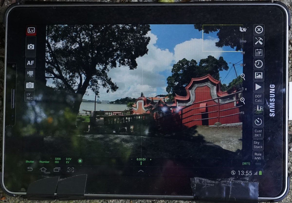

Hi!
Sending two pictures, I think you can undesratnad What it should be great.
I'm aiming for the top of the tree in the middle of the image.
The second image you can see the center of the image, but with a circle in the middle where the image is magnified x5.
This allows me to have a high degree of alignment between images.
In hypertimelapse work, this would be very useful.
thanks for your time.
