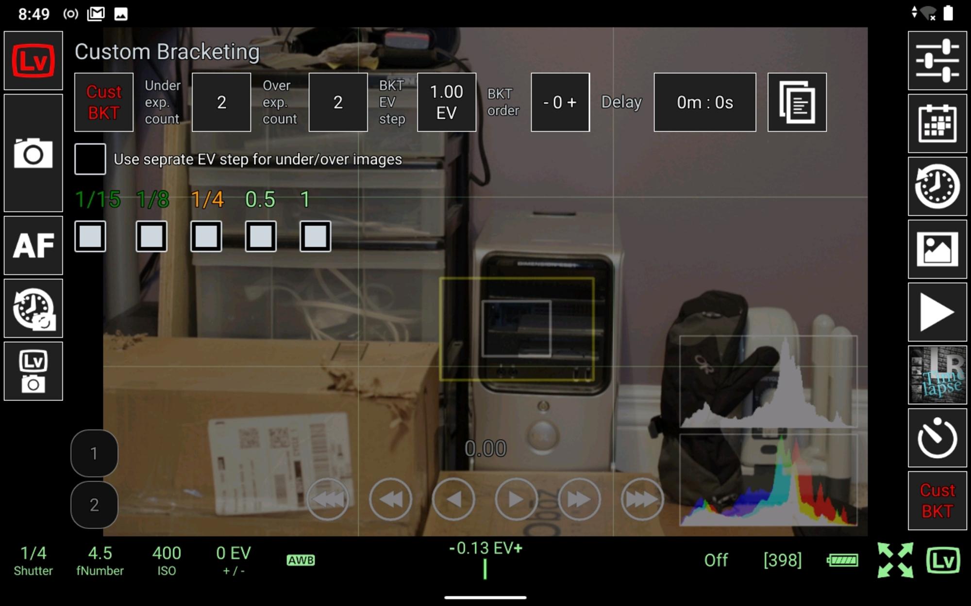

I setup the custom bracketing as seen in the screen shot.
Custom Bracketing.jpg (208.57 KiB) Viewed 8192 times
Instead of taking all 5 shots, it only takes three of them. It always takes the first one and then randomly takes 2 of the next 4. I made a movie of one and here's a link to that: https://www.dropbox.com/s/wjpghm2wc8skb ... 0.mov?dl=0
It took one at 1/15, then 1/8 and the last one at 1(-2, -1 and +2).
I'm using the Android version on both a Lenovo Tab M8 and a Samsung Galaxy S9. It acts the same on both. I'm also using the TP Link MR3040, but I get the same results when connecting directly the camera's wifi. The 7D MKII always takes all 5 shots.
I did find an easy work around for the 6D MKII. If you set the camera to take bracketed shots, then you can use qDslr just as though you're taking a single shot and everything works fine. I still have full control of the camera through qDslr. Since the 6D MKII has two custom settings on the mode dial, I just saved one to do bracketed shots and I can switch to that one whenever I need to.

Before you connect the camera try enabling/disabling the 'Use Canon local storage' option.
Also try adding a small delay, just to see if it will complete all captures (like 2-5 sec)
Re: Canon 6D MKII
Posted: 09 Feb 2021, 21:49
by tadrscin
Thanks for the reply. I tried both ideas and neither one worked. The delay didn't actually add any delay between shots no matter how long I set it to. I even tried 10 minutes just for the heck of it and no delay between shots. Same thing on the 7D MKII, although it still takes all 5 shots every time.
