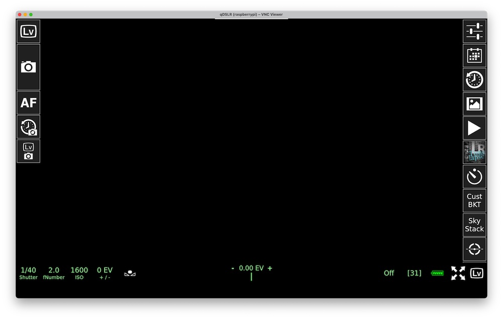

Hello qDDB Community,
On my summer holidays I wanna try to take some shots of the Milky Way and the Perseids and maybe als try to capture a holy grail time-lapse right away.
Unfortunately there is no App for iOS available any more. Therefore I tried to use a Raspberry Pi 4 with qDDB and finally I even got it to work.

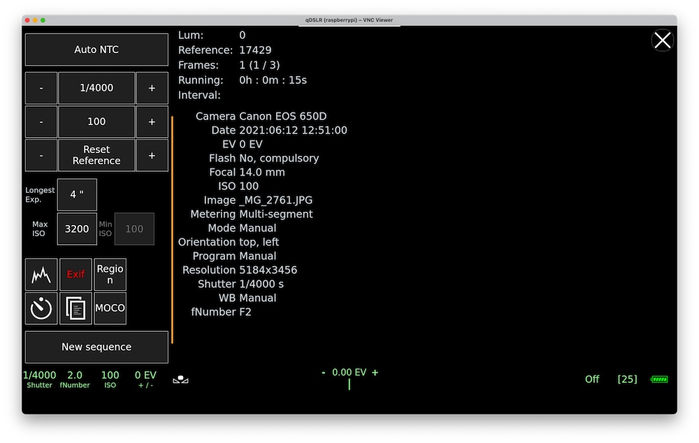

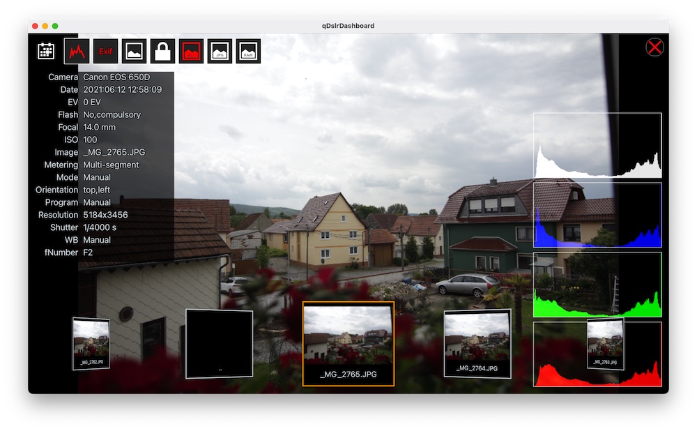

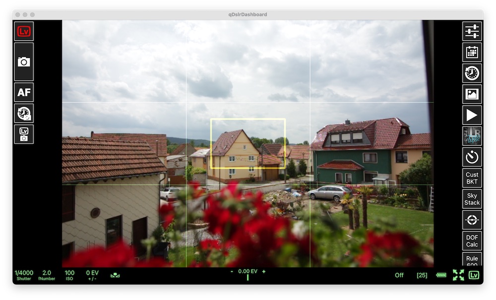

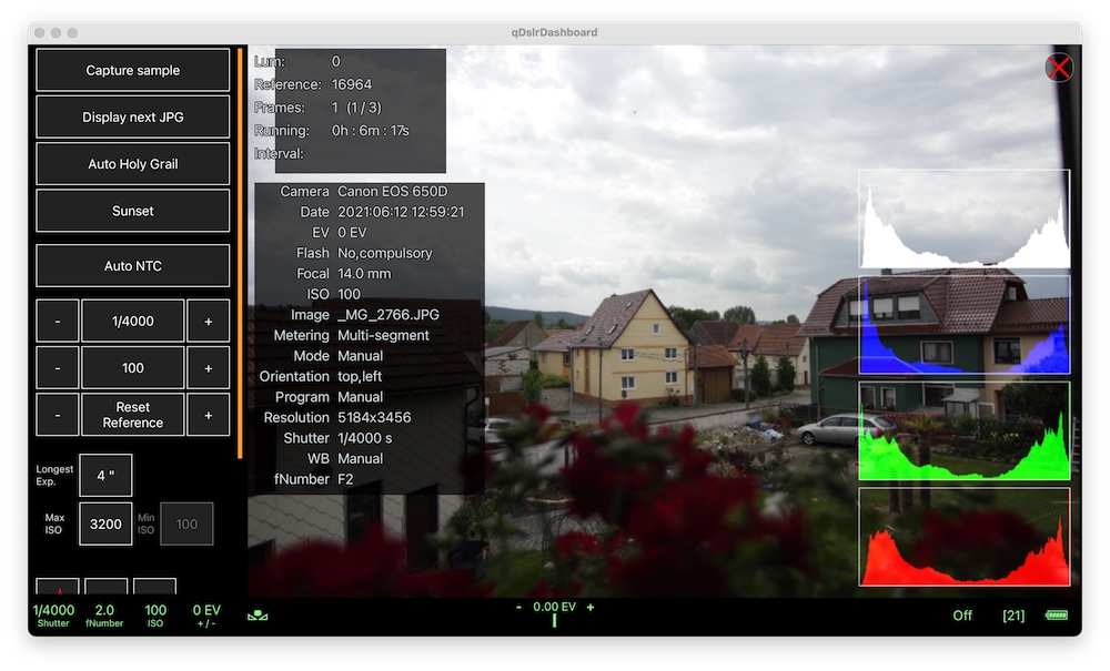

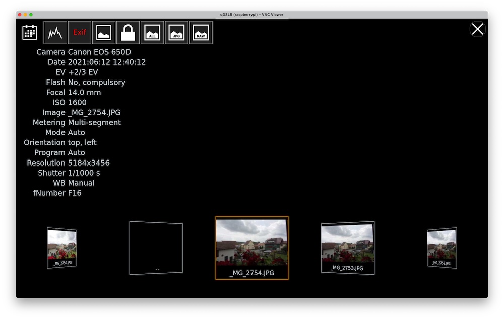

The Problem is, that I don't get a Live View picture on the Pi, the screen keeps black. Even in the gallery it shows me the thumbnails and I can see that the pictures are loaded, but they don't show up on screen. And also in LRTimelapse-Mode, when I capture an image, it is analyzed but not shown. Also the histograms can't be shown on screen. On my MacBook it works all fine, see pictures below.
Another problem I have noticed is, that the icons on the upper left don't turn red when activated.
Does anybody else have similar problems or even knows how to fix it? Many thanks in advance, I hope you can help me.

Did you try running it on RPI 4 with a monitor attached to the HDMI port or only with VNC?

Yes I did. I attached to my Smart TV and it is also connected to an 5.5“ AMOLED screen from Waveshare. Same problem.
VNC just was easier to take screenshots.

Unfortunately I didn't find a solution yet. Is it only the Liveview for you or do you have the same problem with the images in the gallery and the preview in LRTimelapse?
