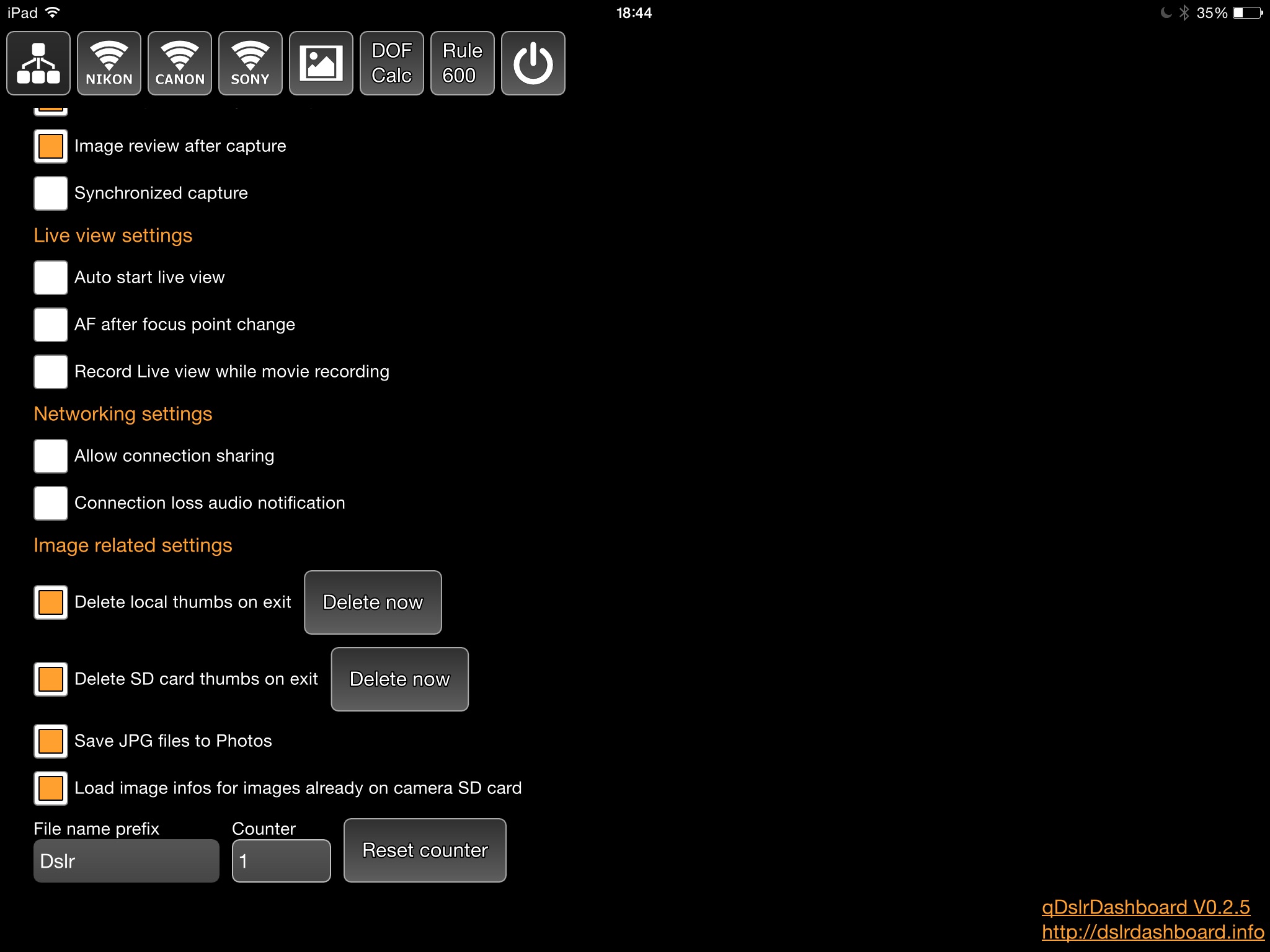

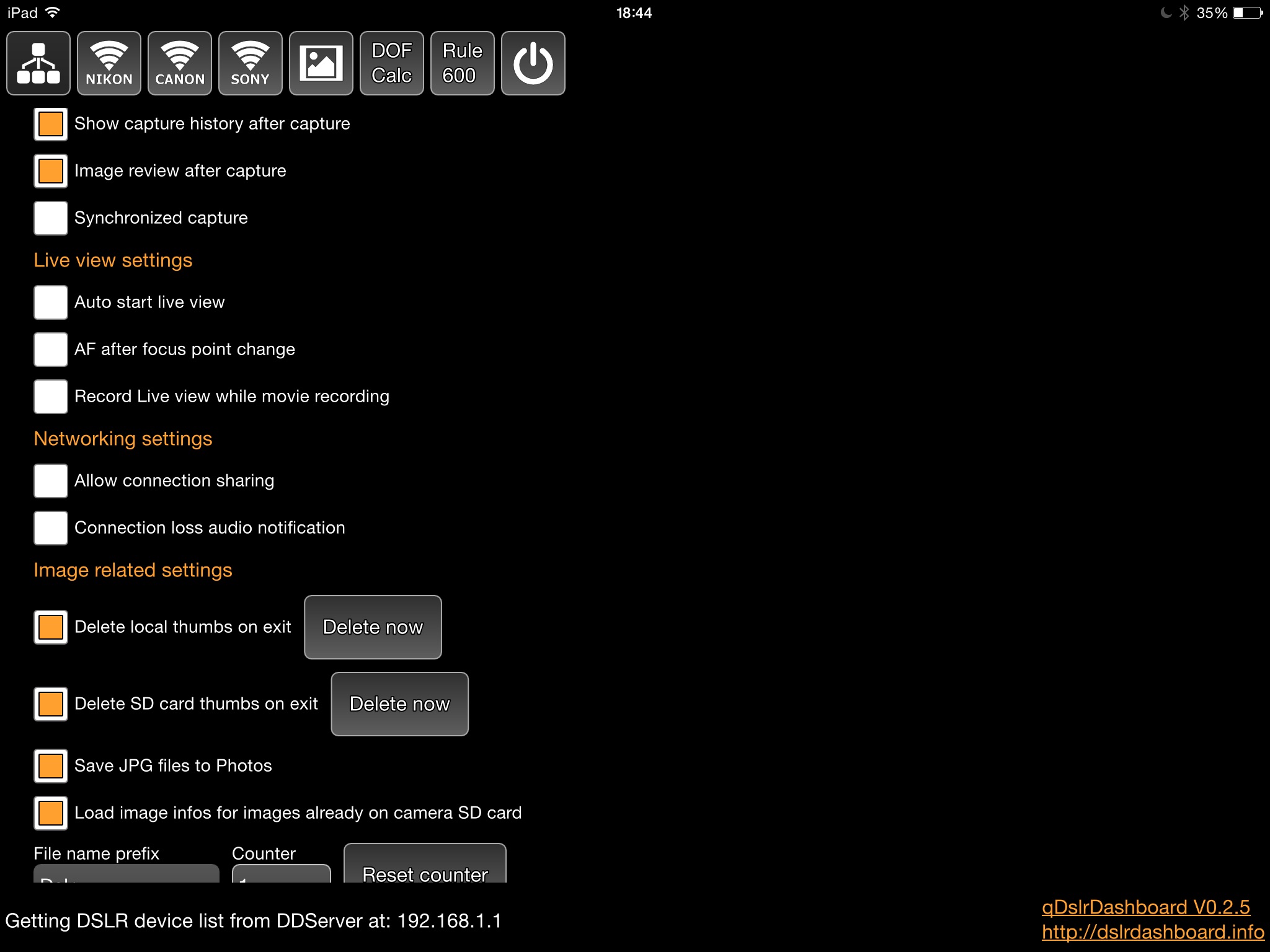

I tried the tip but it doesn't works. I can not access this IP address neither from my iPad nor from my laptop.
Your second advice also didn't work. I pressed long the Network button, then the IP address appeared, I pressed Submit, but the result was nothing as you can see in the attached photos.
Do you have any other advice please. I really need to have this thing sorted out.

Re: Failure
My dear friend,
Thank you a lot for your advices and sorry for my stupidity.
Everything is working fine now.
Guess what! On the iPad I forgot to select the router's wireless network before anything else.
