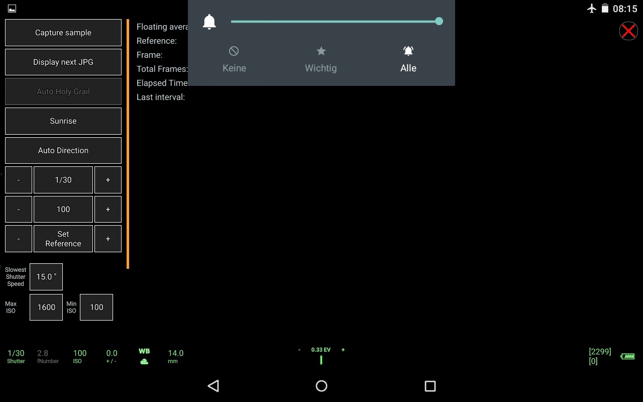

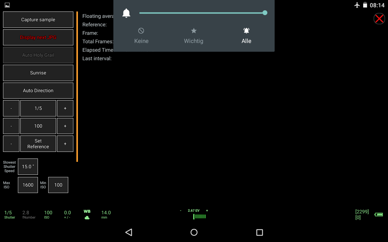

strange, I can not activate auto holy grail (AHG) method. Please see screenshots. Did anybody encounter similar problems? First it worked with Version v0.3-10 on Nexus 7 android but the second night it did not (do not know if I changed any setting on the D800. After capture no jpg is loaded to the app. On a Sony a6000 using wireless AHG is working fine.

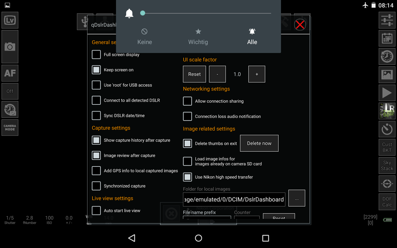

Please check my settings. After a single capture the camera switches to host mode automtically although camera mode is default.
After capture also the jpg does not load to qDD. I guess this is the reason why AHG can not be activated. Ok the sound level menue blocks the qDD display but I can assure that the jpg did not upload to the app. One can use other functions, live view etc but not AHG. Can anyone help?

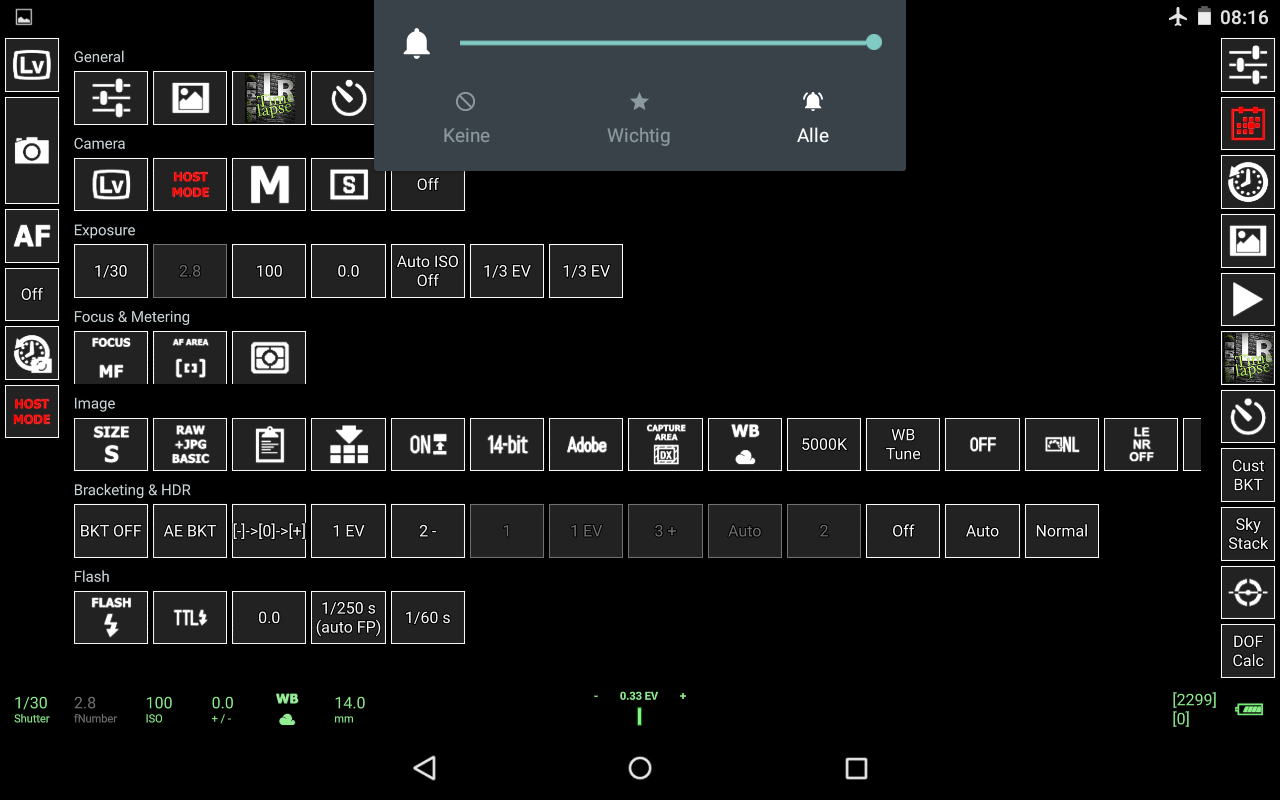

Forgot to show these settings:

It does not make a difference if I use the internal or external timer. AHG can not be activated because the jpg is not downloaded to the nexus 7 LRT modus. As soon as possible I will test the D800 with unchanged settings over Tp-Link 3040.
