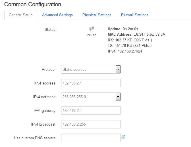

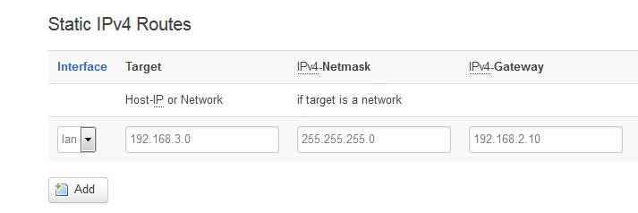

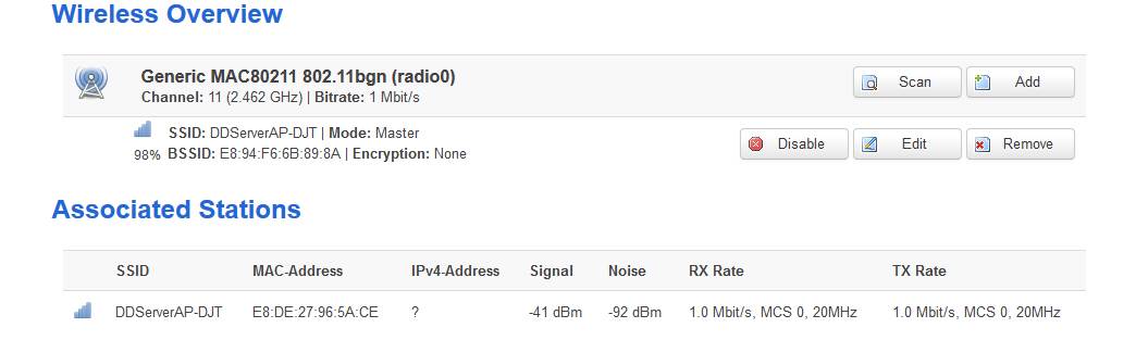

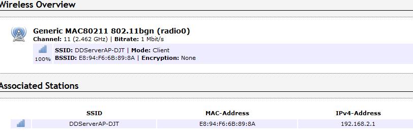

Re: how to install ddserver on a 3020 tplink router ?
Here are the screenshots of the both configurations
Thank you to have a look
maybe it's not normal to have a question mark for the 3020 associated station IP ( first screenshot )
Best regards
Dominique
Best regards
Dominique
- 3040-wireless-overview.jpg (32.65 KiB) Viewed 133034 times
- 3040-static route.jpg (14.04 KiB) Viewed 133034 times
- 3040-lan-interface.jpg (26.16 KiB) Viewed 133034 times

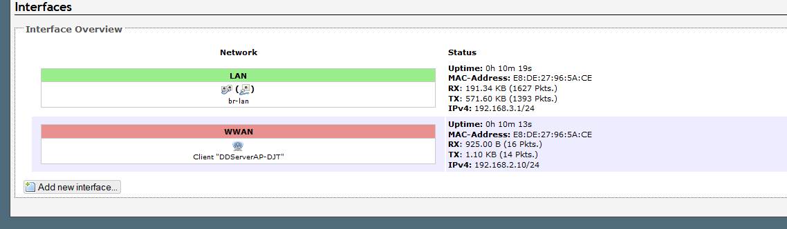

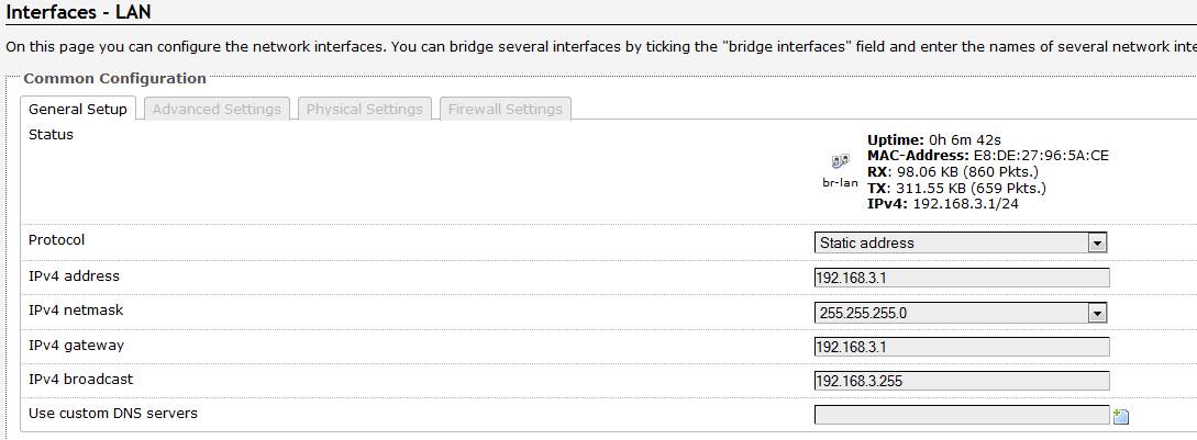

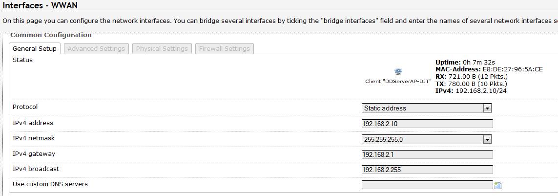

Also the 3020 screenshots about interfaces
- 3020-wan-interface.jpg (58.68 KiB) Viewed 133034 times
- 3020-lan-interface.jpg (56.21 KiB) Viewed 133034 times
- 3020-interfaces.jpg (41.2 KiB) Viewed 133034 times

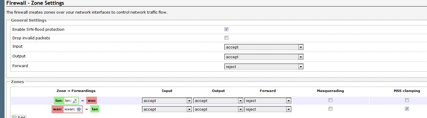

last screenshots about the 3020 ( firewall and Wifi )
Thank you very much
Dominique
Thank you very much
Dominique
- 3020-wireless-overview.jpg (29.48 KiB) Viewed 133034 times
- 3020-wireless-network.jpg (79.84 KiB) Viewed 133034 times
- 3020-firewall.jpg (67.73 KiB) Viewed 133034 times
When you connect your PC wireless with the AP wireless
- can you access the http://192.168.2.1 from your web browser
- can you access the http://192.168.3.1 from your web browser
in qDD if you long press the 'Network' button and enter 192.168.3.1 and then connect can you access the connected camera?
