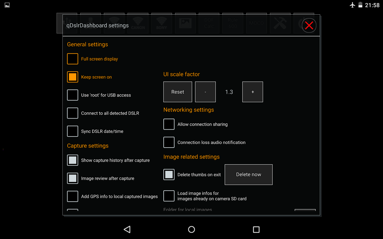

Can you maybe try and turn on the 'Keep screen on' option. Probably Android is killing qDslrDashboard while it is in background.
Re: LRT gives overexposed images

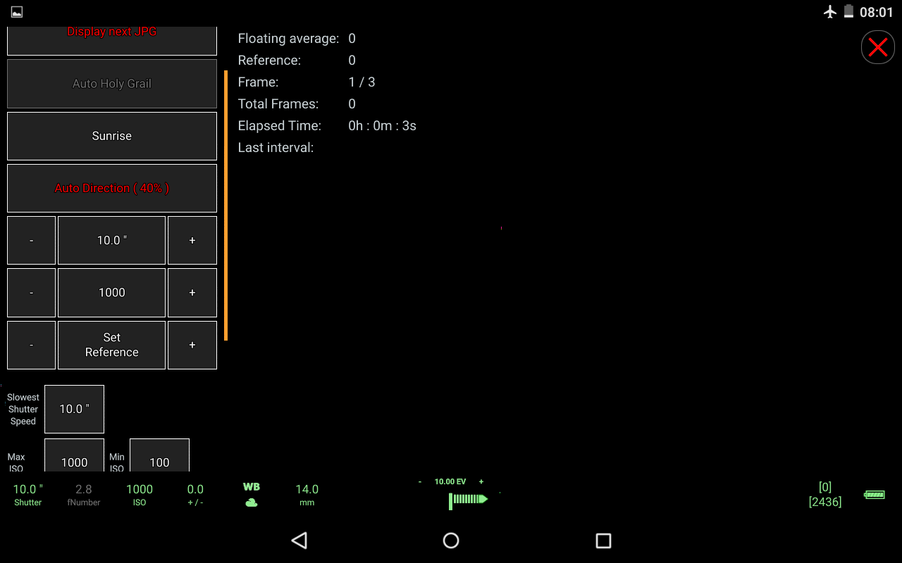

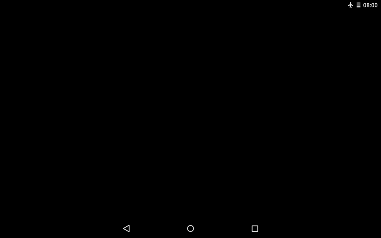

Hello Zoltan,
Last night I started the D800 and nexus 7 5.1.1. (2012) at 23.00 hours. Settings as usual 10 sec, iso 1000, 2.8 (fixed) auto holy grail on. See further settings in the attachment screenshots. Also I checked 'keep on screen' at 5 am in the morning tablet connection had been lost. I could only reconnect the app after I restarted the nexus (works only if USB cable disconnected). Restarting the nexus while USB cable connected can not restart the qdd app. Next time I will sit next to the nexus to see when the connection app-D800 gets lost for sunrise. At 5 am in the morning no adjustments had been taken, camera (camera mode) was still in 10sec. iso 1000.
For my latest sunset experiment I was quite happy with the 'region' function. I could reduce overexposition.
Miksel
