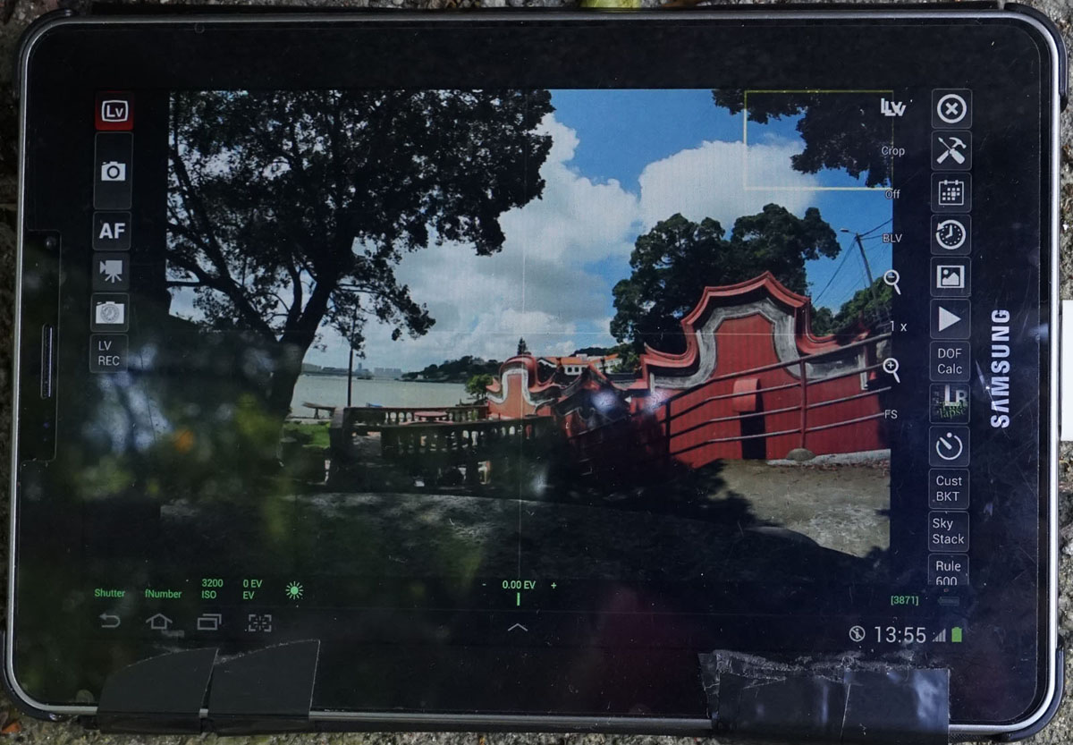

I do hypertimelapse, and using a bigger display screen (7.7" tab) instead the LCD that comes with the DSLR is a big bonus, since I can line up each picture as most accurate as I can, to avoid big complications in post-production.
Would it be possible to display in the middle of the picture with the cross hair a zoom in portion of the picture (let's say 150%) so I can accurately align each picture even better.
I often need to zoom in the live view picture, but I start very fast to lose the perception of the rest of the image.
thanks

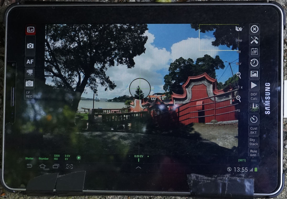

Hi!
Sending two pictures, I think you can undesratnad What it should be great.
I'm aiming for the top of the tree in the middle of the image.
The second image you can see the center of the image, but with a circle in the middle where the image is magnified x5.
This allows me to have a high degree of alignment between images.
In hypertimelapse work, this would be very useful.
thanks for your time.

Please try this beta build: https://drive.google.com/file/d/0BxMZ8X ... sp=sharing
You will have in the live view column a cZoom button.
With it you can enable center zoom.
You have 2 sizes and for both 2x and 3x zoom.

Re: live view (image zoom in the middle of the picture/crosshair))
PERFECT!
tested with a xiami mi4w
android 4.4.4
quad core at 2.5GHz
Samsung 7.7 GT-P6800
android 4.0.4
It is perfectly implemented, thanks a lot, and the ability to have three type of image magnification is a very nice touch indeed.
Better yet, you don't need to press any buttom, and better still the grid stays there with the magnification in place.
In the original sony camera software, when you press the zoom function, the grid goes away.
One thing I noticed when connected with the xiami, is that the wifi delay between the camera and the app is almost gone, one reason being the fast processor in the phone I tested with. (I think).
The only thing really missing for hypertimelapse to use the sony, is the ability to see the "artificial horizon", already implemented when working with canon and nikon cameras.
It would be the perfect setup, small lightweight camera, tons of megapixels, with almost all of the functionality that I need.
many thanks and waiting for that "artificial horizon"
regards
lightime
