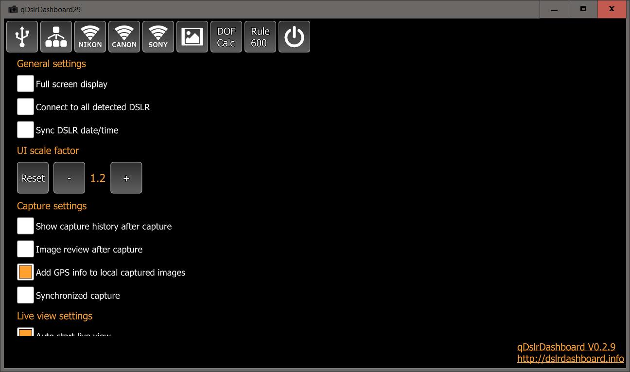

I have a directory for v 0.2.9 and one for 0.3.3 (on Windows 10 64 bit)
V0.2.9 start with an expected screen
and when I am wirelessly connected to my camera ( Nikon D7200) it allows me to use live view and take a snap.
(It then crashes when it tries to download the image.)
so I switch to 0.3.3 Its first screen is more plain
add if I select Nikon it connects to the camera (as indicated by the camera) but the screen remains as shown and I can get no further.
If I switch back to 0.2.9 it work again so I assume my connection is OK but something is amiss in the code. (or my setup!)
