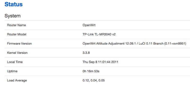

Installed OpenWrt firmware on my MR3040 v 2.4...I didn't do the ddserver version. Any suggestions on what the next step could be? I would google this, but I only have a superficial knowledge of what's going on and don't want to brick the thing. Any help would be appreciated.
Screen Shot 2015-03-25 at 11.26.58 PM.jpg (43.81 KiB) Viewed 12001 times
Re: Installing DDserver on MR3040 with existing OpenWrt
You should upgrade the MR3040 firmware by following this guide: http://dslrdashboard.info/tp-link-mr304 ... e-upgrade/
using the sysupgrade image for V2 from here: http://dslrdashboard.info/downloads/
