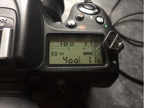

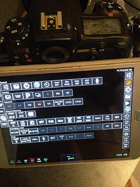

Just noticed that the qdslrdasboard doesn't show the correct exposure when connected. Please see photos attached. As you can see te camera is showing a correct exposure but on the second one the qdslrdasboard is over exposes by +.33
I have a D7200, lates qdslrdasboard version and latest ddserver on the tp link mr 3040.
Any suggestions.

No, it's not wrong, and it cannot be wrong. qDD does not shows exposure by it's self. It only shows what is on camera.
If it shows + 1/3 EV than it is what was send by camera.
Also if you compare exposure measurements in LV with those via viewfinder - check camera manual - they won't be always the same.

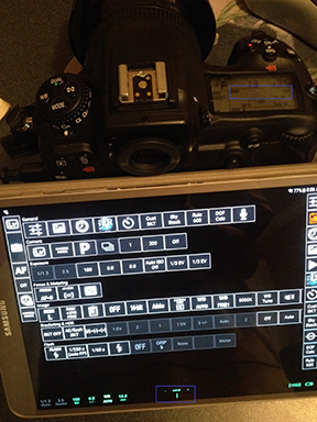

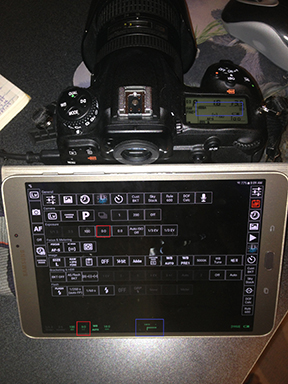

sorry if it's difficult to see...may need to download and zoom to see the details...
changes to EV values were made using qdd only...
blue boxes - no exposure bar on camera...value 0 on qdd green exposure bar
red boxes - non-zero EV values (+3) on camera and qdd
blue boxes - exposure bar on camera (overexposure)...non-zero value on qdd (overexposure)
red boxes - EV value set to 0...both EV values are refreshed/updated to 0
blue boxes - no exposure bar on camera yet qdd is not 0 like image 1, ie same non-zero value on qdd, not refreshed/updated
exit qdd then restart forces it to refresh everything...qdd will show 0 on its exposure bar
