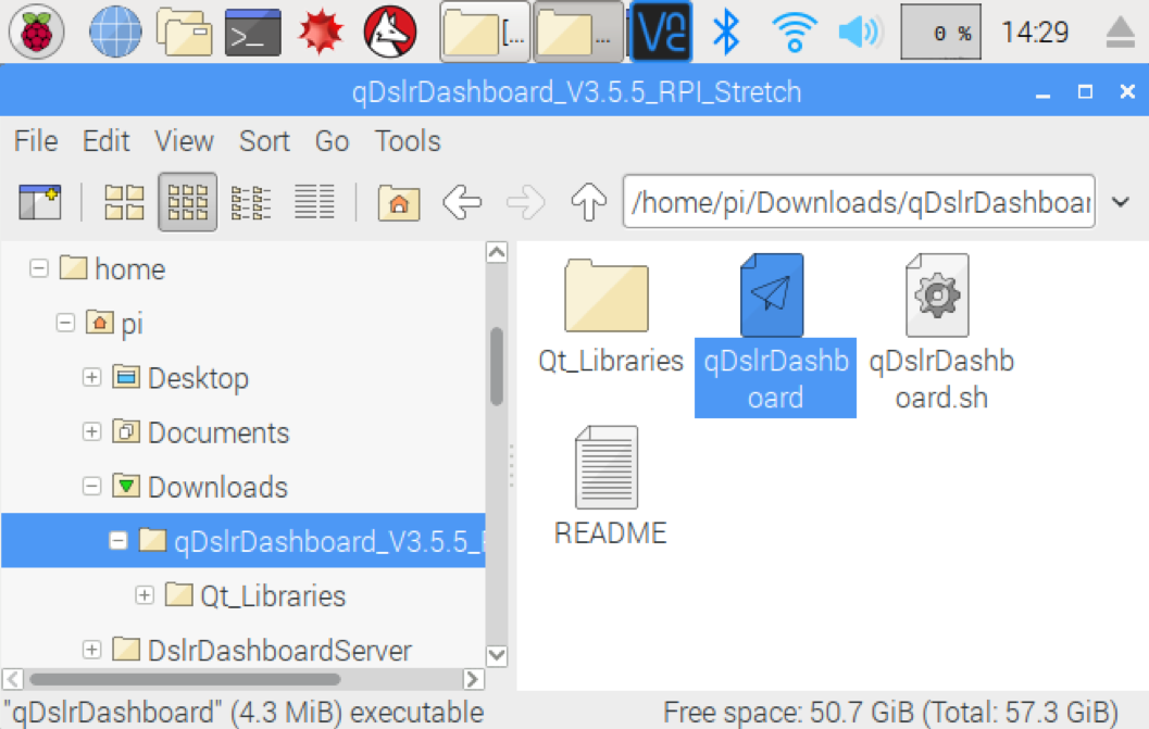

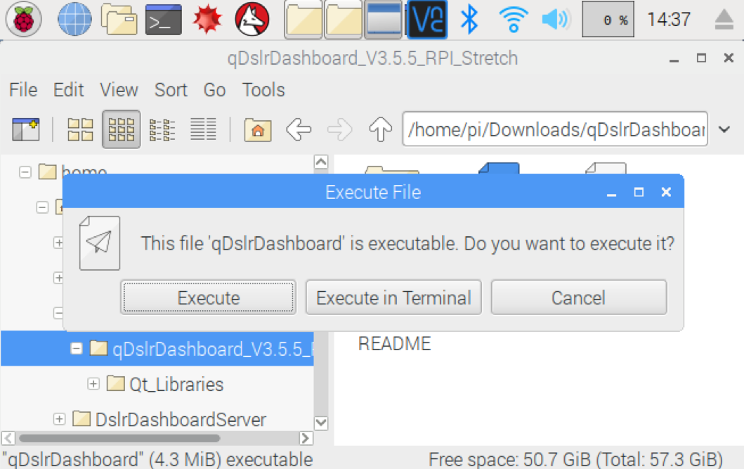

On my Raspberry 3, I have installed Raspbian Stretch and downloaded V.3.5.5. FOR RASPBIAN STRETCH. When I double-click on "qDslrDashboard" or "qDslrDashboard.sh", a window "Execute File" appears, but when I then press "Execute", nothing happens. How can I properly install and start qDslrDashboard?

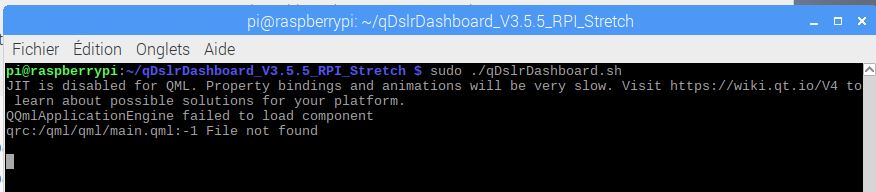

After installing the dependencies, when running the qDslrDashboard script. I have the following message:
JIT is disabled for QML. Property bindings and animations will be very slow. Visit https://wiki.qt.io/V4 to learn about possible solutions for your platform.
QQmlApplicationEngine failed to load component
qrc: /qml/qml/main.qml: -1 File not found
Can you help me ?
Capture raspberry.JPG (38 KiB) Viewed 19558 times
Re: Install qDrslDashboard on Raspbian Stretch
Please check this post: viewtopic.php?f=6&t=2468

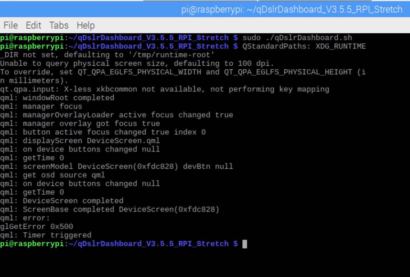

@hubaiz: thank you for your answer. I've done all steps mentioned in your suggested post. However, the program does not start, I get the following output in the terminal. I'm connected via VNC to my Raspberry 3 since I don't have a monitor. Any idea what causes this issue?
Screen Shot 2018-02-22 at 16.26.47.jpg (85.77 KiB) Viewed 19539 times
It will not work with VNC as it can't transmit OpenGL as far I know.
