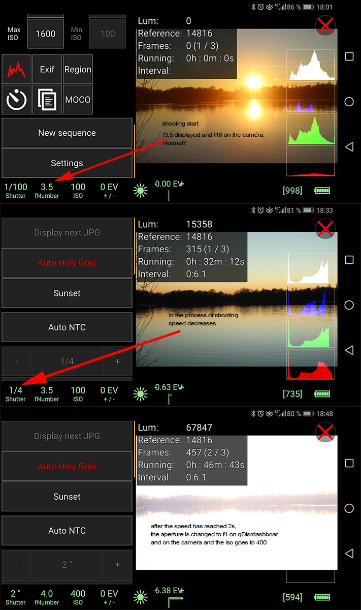

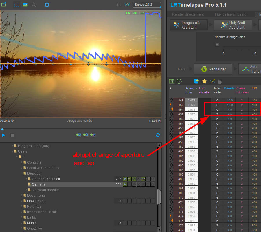

Hello, I tried a holy grail sunset and had a problem when ltimelapse could not decreases speed.
my initial settings were: 1/100s, f16 and 100 iso. In Lrtimelapse, I had set f3.5 mini, 2s maxi et 800 iso maxi.
When Lrtimelapse arrived at 2s, he changed aperture to f4 and the iso to 400.
Which give the image lighter.
I tried to change the value in Lrtimelapse and click on the "-"button and the aperture and iso parameters does not change.
I attach screenshots
Someone can help me

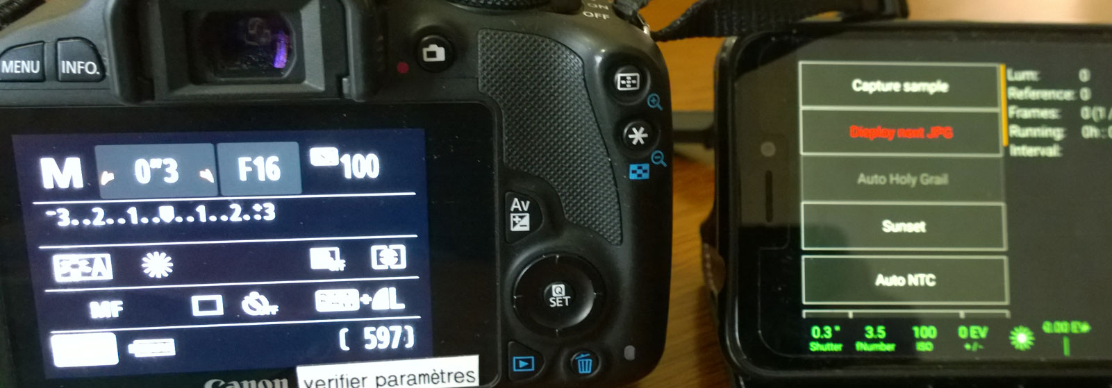

I use a Canon 100D. I tried this morning and I realized that if I set my camera to f16, then I connect my smartphone and lauch qDlsrdasbord, it does not display the correct aperture value (see attachment). If I change the aperture on the camera, qDlsrdashboard gets updated. Is this normal? Whenever I can, I will do it again a holy grail.
