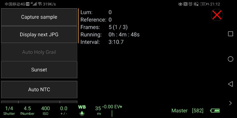

Hello.
Z7 can connect Huawei mobile through wifi.
After go to LRT, Click on "Capture Sample", but preview shot don't appear, can't get "Auto Holy Grail".
Camera: Nikon Z7
Platform: Android 9.0
Hardware: HUAWEI Mate 10 Pro EMUI 9.0.0
What should I do?
Thanks.

I did connect the camera to my Mate 10 according to your instructions, but after clicking “Capture Sample”, the preview shot still does not appear.

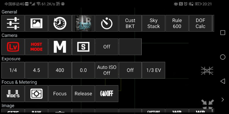

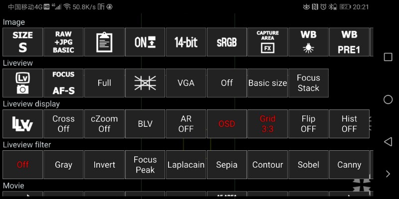

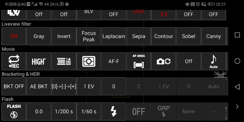

What are the camera settings, can you make a screenshot of that to (second button from top on right side)

My camera setting.

as far as I understand the problem, you will not be able to use the Auto Holy Grail with the camera in Host Mode.
Try setting it to Camera Mode and turn off the Dashboard LiveView.

Re: Z7 can't get Auto Holy Grail
Mjj wrote: ↑18 Jul 2019, 19:25 Hi,
It will work while host mode is enabled and with live view enabled but the external interval timer will not be able to trigger the capture.
On Z6 and Z7 you can disable host while still in live view.
