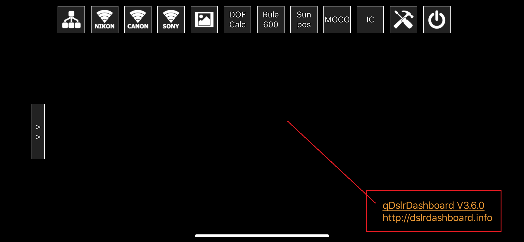

I managed to purchase qDslrDashboard iOS, and updated to V3.6.0, using iPhone XR & Nikon D810. And found out 2 issues:
iOS V3.6.0
iOS V3.6.0

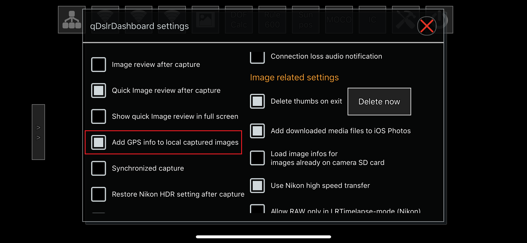

#1. Add GPS info is not always working.
My DDServer router does not have Internet connection. Sometimes I can get the coordinates attached to the downloaded pictures, but most of the time can not. And manual entry GPS, never got it works.
I've tried to capture with LV on/off, Image review after captured & Quick image review after captured on/off.
Since I can't find any usefully document about this, just don't get any clue how to make it always working.
I've check the option
GPS info display
GPS info display

If I marked the GPS as Red color, I can only have 1 picture attached the GPS info. But the rest didn't attach any GPS info at all.
These 3 files were shot at the same time, and download to iPhone at the same time:
Why only 1 picture has GPS Info ?

Re: Add GPS info is not always working in V3.6.0 iOS Version
Working on it.
Unfortunately there is no workaround, I need to fix it.
As far I can see the problem is that after the image is downloaded it is shared to the Photos and the GPS info is only added to the file that is downloaded in the qDD private folder.
