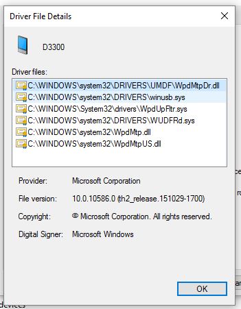

I'm having a problem where its not seeing the d3300 even though the pc see's it and windows photo's works perfectly with it.
Win 10 already includes the winusb driver natively. And it is being loaded for that port.
When I click on the #1 icon nothing happens.
What should I do?
device manager driver details

All windows from XP have winusb driver but use WUDFRd which needs to be changed to winUSB.
With out this qDD won't see camera.
