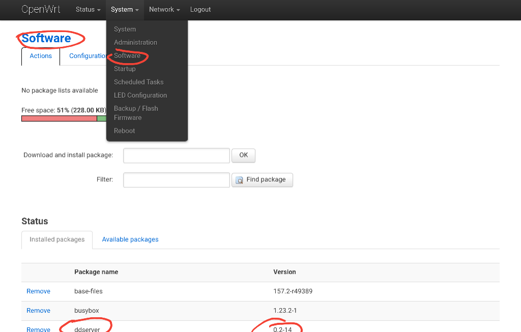

connect to router then login to openwrt...
system -> software
on the software screen, under status and installed packages tab, look for ddserver
adinis78
Posts: 37
Joined: 06 Jul 2015, 13:06
Re: Help with Nikon D7200 and video using app
Post by adinis78 »
Thank you. Finally after who knows how long i got video recording working.
