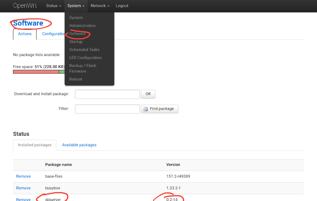

Re: Help with Nikon D7200 and video using app
Posted: 24 Jun 2017, 10:33
by dslr
connect to router then login to openwrt...
system -> software
on the software screen, under status and installed packages tab, look for ddserver
Posted: 26 Jun 2017, 07:43
by adinis78
Thank you. Finally after who knows how long i got video recording working.
