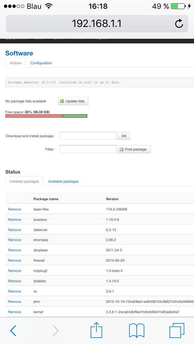

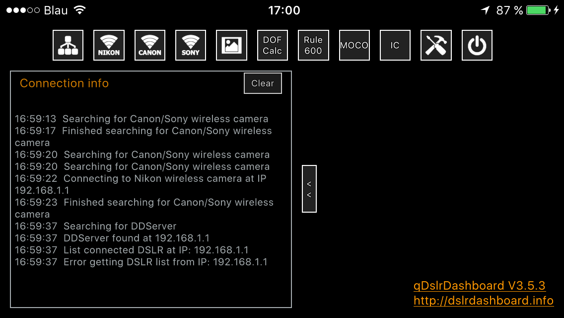

I have the Same Problem with a Canon 5D Mark II. After the First configuration It worked. But since a while it doesn't want to connect to my canon.
I have checked the threat you suggested but I am not able to understand why is not working ... I'm desperate . Can you help?

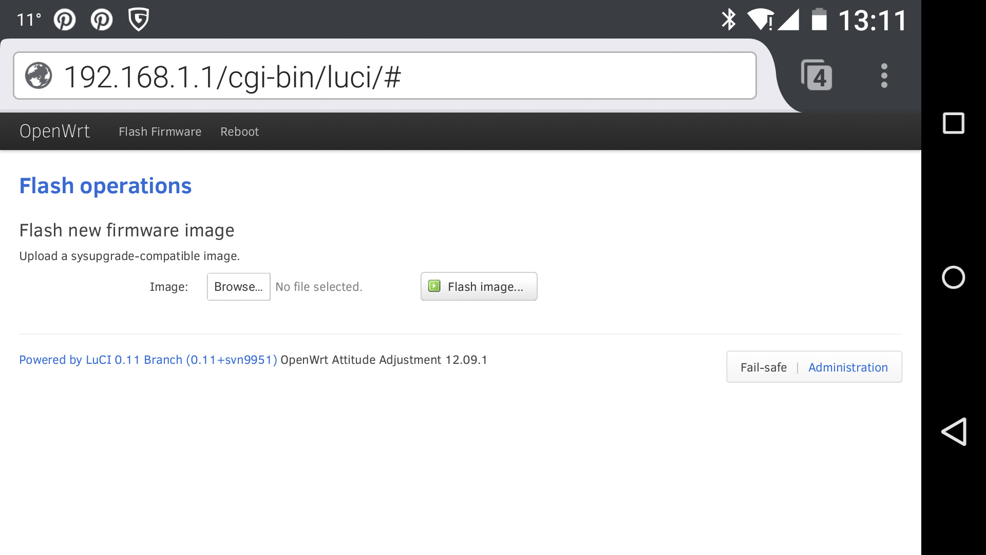

Hi hubaiz,
thanks for your help. I have tried the procedere in viewtopic.php?f=5&t=2101
but there are some points. First, when I connect the nikon with the MR3040 the WLAN flashes. Does this mean something?
Then I followed the way till I connect my advice with the MR3040 and entered the 192...code there opens the OpenWrt-side
with the title flashoperations. I just have the options flash firmware and reboot. There is no chance to navigate to system.
Any idea???
Thanks for your support!

Re: There is no chance to connect
Maybe a screenshot?

It work
So this is what I see at my device (Panasonic phone) when I connect the Nikon (D810) with my MR3040 and open the
browser on my Device and print in the 192.... so I got the problem, that I can´t enter to the system???
