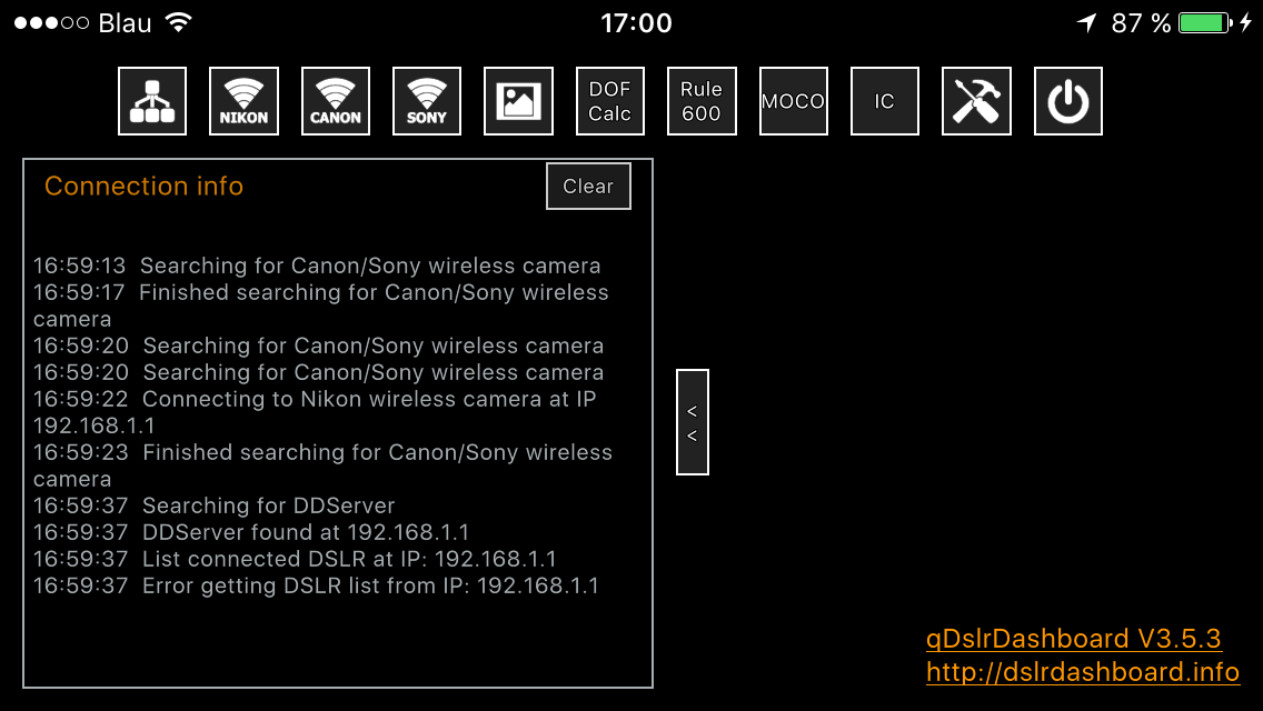

So this is what I see at my device (Panasonic phone) when I connect the Nikon (D810) with my MR3040 and open the
browser on my Device and print in the 192.... so I got the problem, that I can´t enter to the system???
