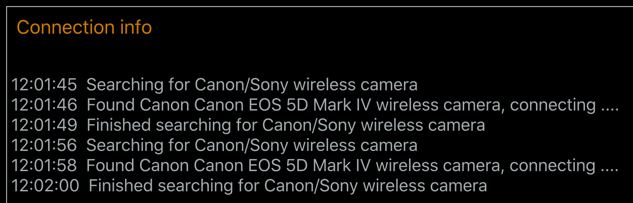

Hello everyone,
I've connected my MacBook to the WiFi network my Canon EOS 5D mark IV is emitting. I can use the EOS tools just fine over this network. When I try to connect qDslrDashboard, I never get past the point of connecting. The camera is using firmware 1.0.4. qDslrDashboard is version 3.5.5. What can I do to fix this?
Best regards,
Bram
Schermafbeelding 2018-01-22 om 12.02.20.png (141.08 KiB) Viewed 7003 times

Same problem. Anyone solved this problem?

It seems that WiFi of Canon 5D Mark IV is not supported yet. Too bad for such a popular camera.

Problem affects only OSX application (my configuration: High Sierra on MBP 15, 2016). WIFI connection with Canon 5D Mark IV on Nexus 7 (2013, Android 6.0.1) works fine.
