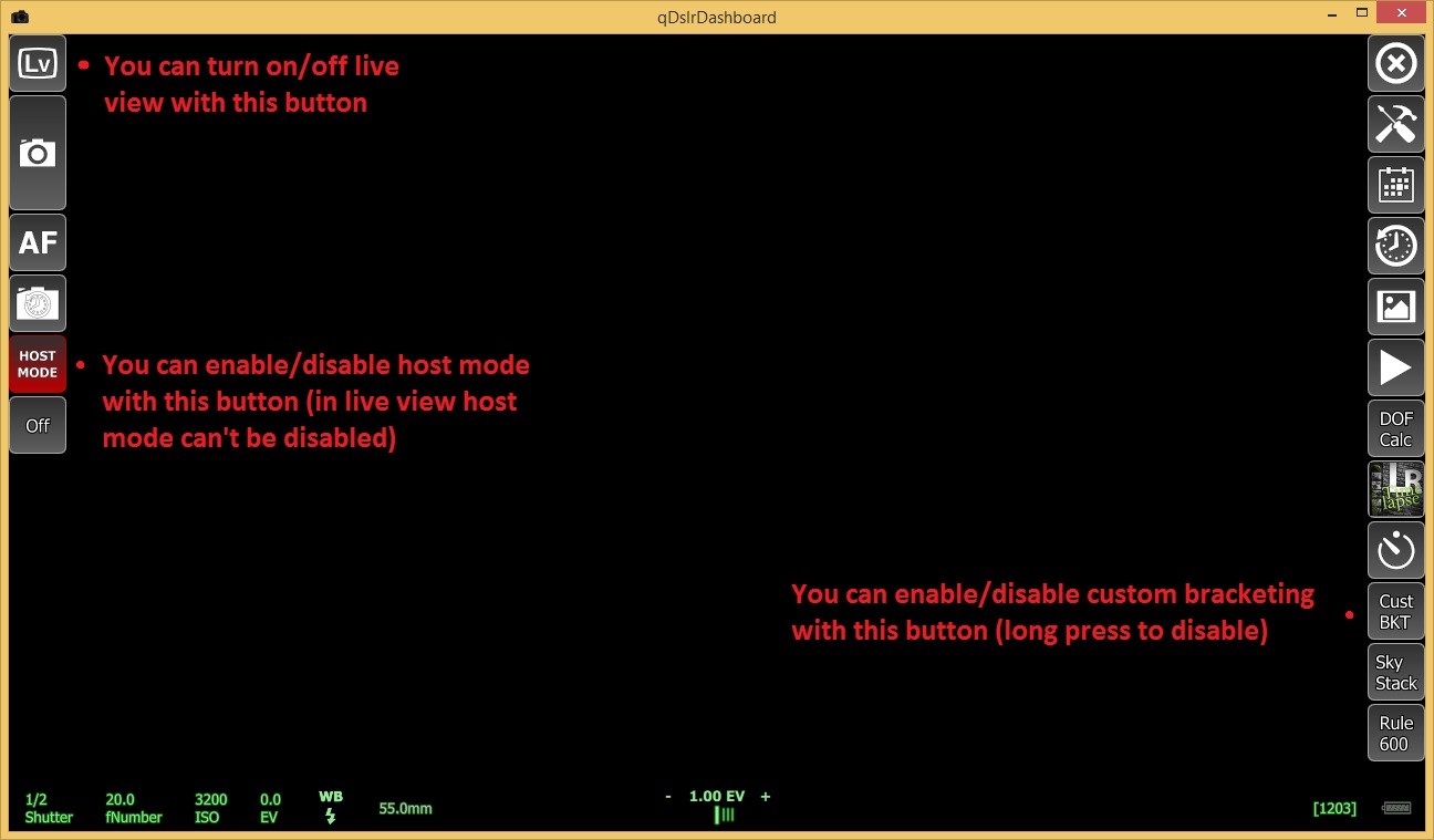

I'm still not sure what you mean under viewfinder. Do you mean this: http://en.wikipedia.org/wiki/Viewfinder
Here is a screenshot of qDslrDashboard
You can enable/disable 'Host mode' with the button I marked in the screenshot. While the camera is in live view 'Host mode' can't be disabled.
I marked the 'Cust BKT' button on the screenshot.

Re: Can I Quickly Toggle On Bracekting / Toggle Viewfinder View?
If your D7000 does not switch directly between LV and viewfinder with one touch of LV bottom that only means that you have something wrong with your camera or connection with camera.
My D7000 works with out problems. One touch turns on LV, another one turns off and no black viewfinder.
When there is a problem with shutter/mirror mechanism it might behave as you described.
