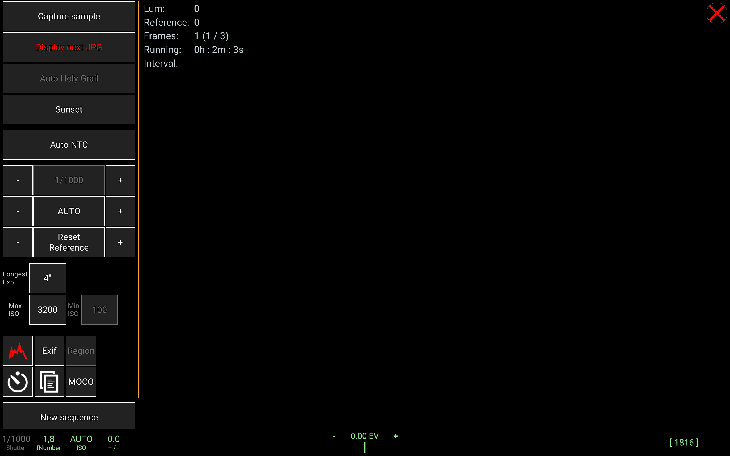

I´m not able to use the holy grail function in the lrtimelapse module with the Sony A6300. It´s no problem to connect my tablet (Samsung Galaxy TabPRo 10.1 with lineageOS) with qDSLRDashboard, I can use the Liveview and all parameters can be changed via app. But when I change into the lrtimelapse module, there is no Liveview available anymore. I still can change the settings (ISO, …) via app and when I take a picture, the app recognizes that, but doesn´t display the picture (display next jpg is activated). And the Holy Grail button is not available at all. What´s the problem?

Edit: I just tried it with another Camera (Sony A6000) and it´s the same issue.

Thanks for your quick reply! I tried it in the M mode, but it´s the same problem. I can capture a photo, the frame counter works and the interval is calculated, but there is no jpg displayed and no holy grail function available. Any other ideas?

Yes, I have the newest version of the remote control app. I tested a little bit today and it seems to be a device issue. With my Samsung Galaxy TabPro 10.1 with Lineage 13.1 I have the described problems. With my Xiaomi Redmi Note 4x with Lineage 14.1 I can hardly connect to your app and when it works the app crashes immediately when I start the lrtimelapse module. But with my Sony Xperia Z5 with lineage 14.1 it works perfectly incl. holy grail. How do I get the tablet (Galaxy TabPro 10.1) to run?

I don't know what could be the problem on your TabPro. qDslrDashboard works same on Lineage 13.1 and 14.1 and also same on your Sony and Samsung device.
