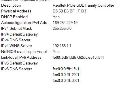

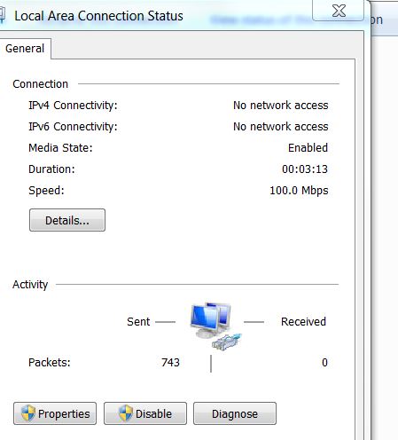

Hi, Ok this is what I have.
Connection Status.JPG (35.17 KiB) Viewed 21142 times
Unable to Connect.JPG (16.28 KiB) Viewed 21142 times
Also have the 3040 in AP as stated on the video.
Have tried setting manualy again as in the video.
Re: New TP 30-40 not seen on computer
Posted: 15 May 2015, 11:07
Does your PC maybe have 2 network ports?
Do you see the light on the network port when you connect your PC with the MR3040?
Is the network adapter maybe set for connection sharing?
