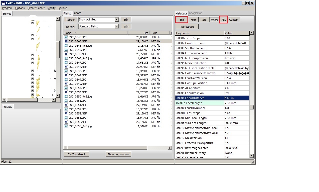

not sure if you can get the data but thought i'd mention it...
need to examine the original nikon jpeg file or raw nef file
jpeg file saved from other softwares, such as photoshop, will strip out nikon metadata
i examined files from nikon d300 and d7200 with lenses 18-200mm and 70-300mm
exif has
0xa40c SubjectDistanceRange but its value seems to always set to 'Unknown'
nikon proprietary metadata has
0x000a FocusDistance. value is in meters
i used this free tool exiftool by phil harvey
http://www.sno.phy.queensu.ca/~phil/exiftool/
it is a command line tool. the companion gui for windows is exiftoolGUI
http://u88.n24.queensu.ca/exiftool/foru ... 750.0.html
in the top forum posting, click where it says
Click here to download ExiftoolGUI v5.16 (in green)
by default the exiftoolGUI looks for exiftool.exe in C:\Windows (may need to search for exiftool.exe and copy or move it to c:\windows)
by default, only tag names are displayed. to view the tag ids, options -> prefix tag names with id number
attached is a screenshot of exiftooGUI examining a raw NEF file (i've erased the directory hierarchy in the 'browse' section on the left)
Maker - nikon metadata
Exif - standard exif data
ALL - all data (standard, nikon, etc)
exif has
thanks...

Re: Subject distance
nikon metada vs exif
http://www.sno.phy.queensu.ca/~phil/exi ... Nikon.html
Nikon LensData0204 Tags
Nikon encrypts the LensData information below if LensDataVersion is 0201 or higher, but the decryption algorithm is known so the information can be extracted.
Index1 Tag Name Writable Values / Notes
0 LensDataVersion N
4 ExitPupilPosition int8u
5 AFAperture int8u
8 FocusPosition int8u
10 FocusDistance int8u (this focus distance is approximate, and not very accurate for some lenses)
11 FocalLength int8u
12 LensIDNumber int8u (see LensID values below)
13 LensFStops int8u
14 MinFocalLength int8u
15 MaxFocalLength int8u
16 MaxApertureAtMinFocal int8u
17 MaxApertureAtMaxFocal int8u
18 MCUVersion int8u
19 EffectiveMaxAperture int8u
