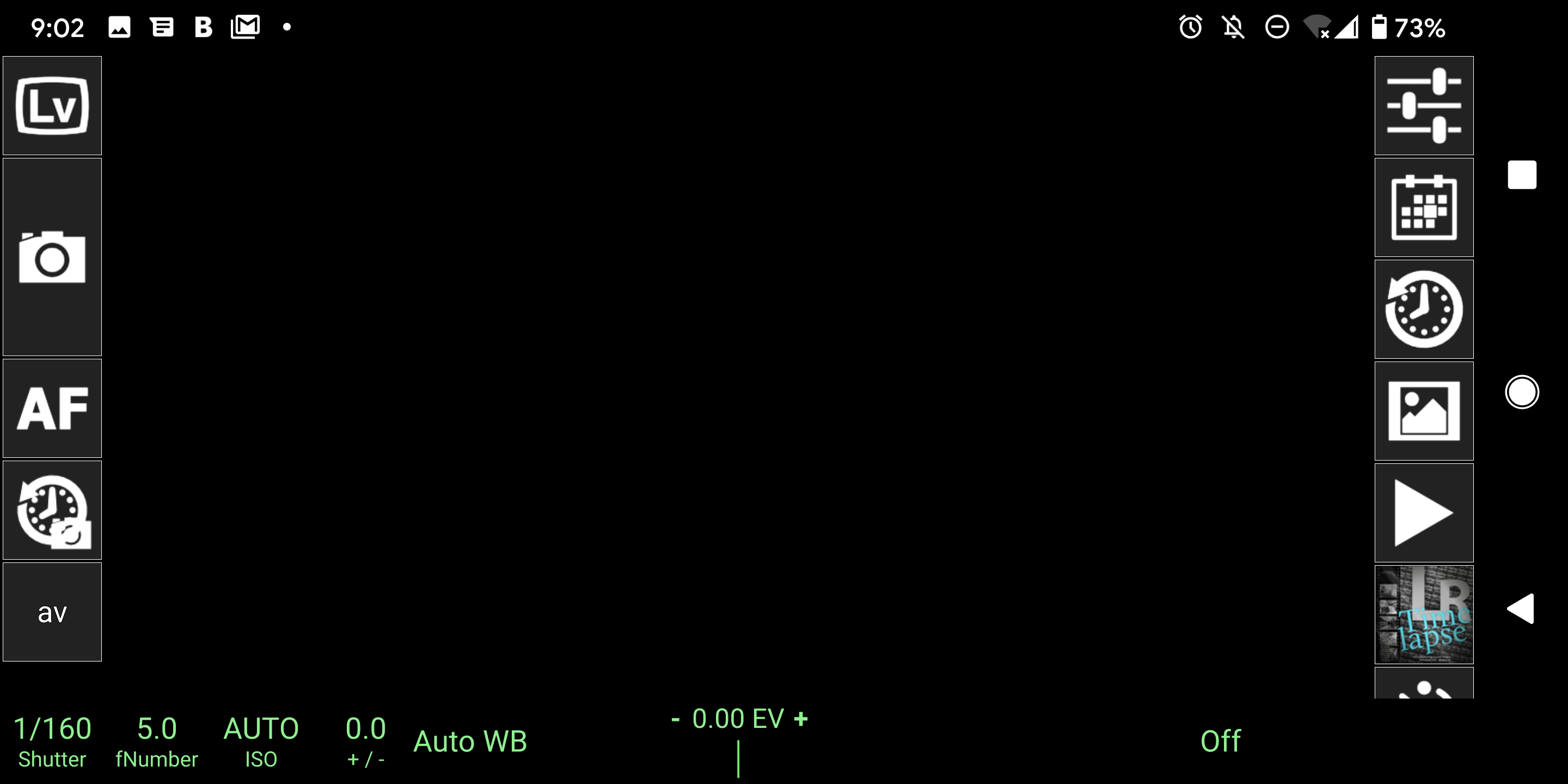

3) In the left menu, there is a button near the bottom labeled “av”. If I press this button, the live view disappears from the app, the red “Lv” button in the upper left turns grey instead of red, and the app will not respond or bring the live view back unless I restart the phone and the app and reconnect (see two screen shots below)

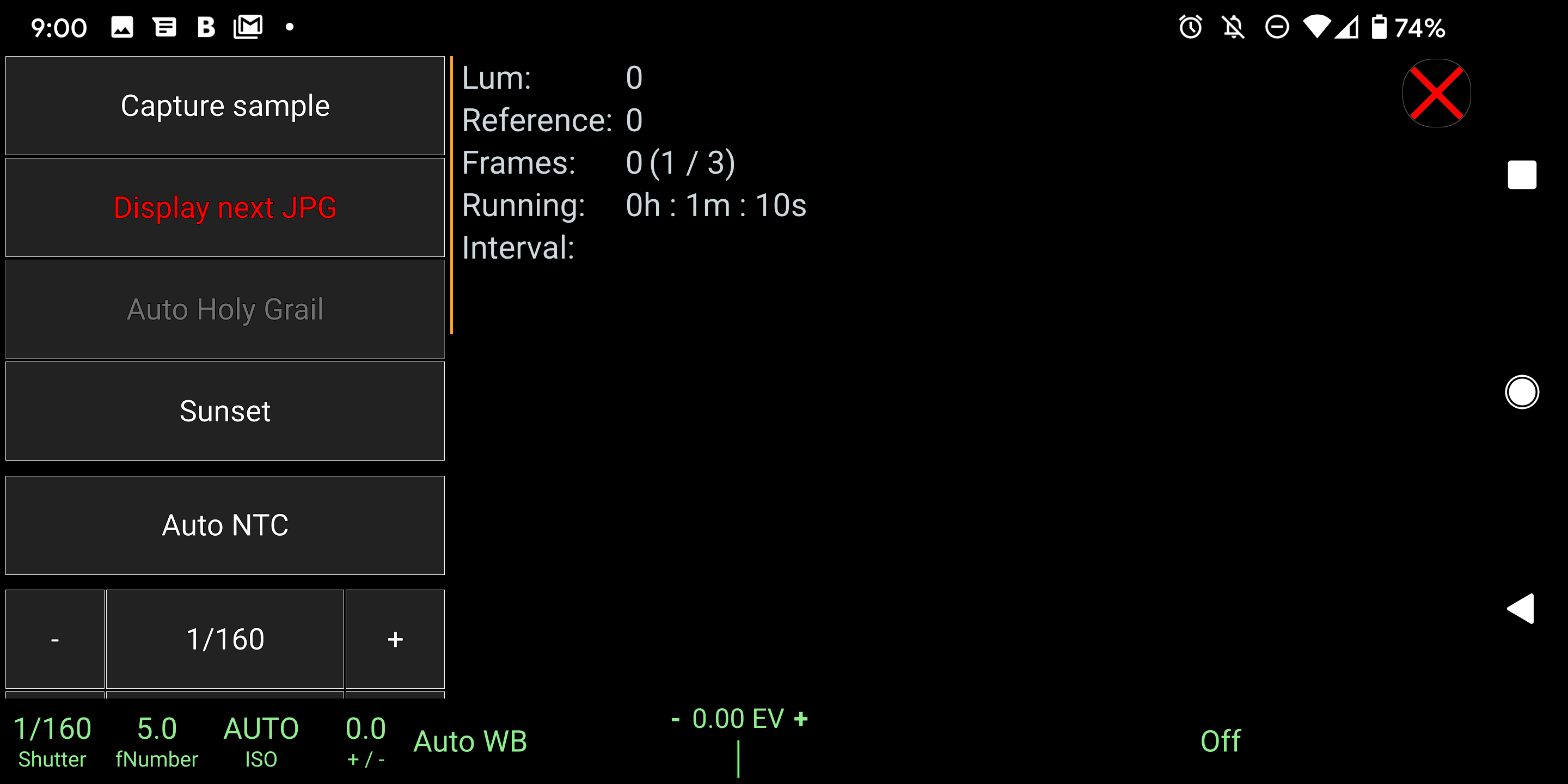

4) In the LRTimelapse Module from the right menu, if I hit “Capture Sample” it shows the “capture in progress” again, but again nothing happens. No image is recorded to the phone or the camera and no preview shows up in the LRT screen. Also, the Auto Holy Grail button is grayed out and cannot be selected. Again see screenshot below.

screen at LRTimelapse module
screen after hitting the “av” button
