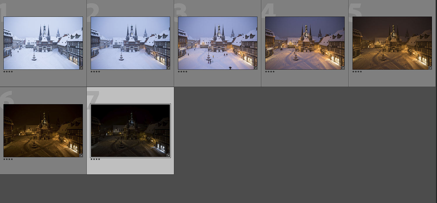

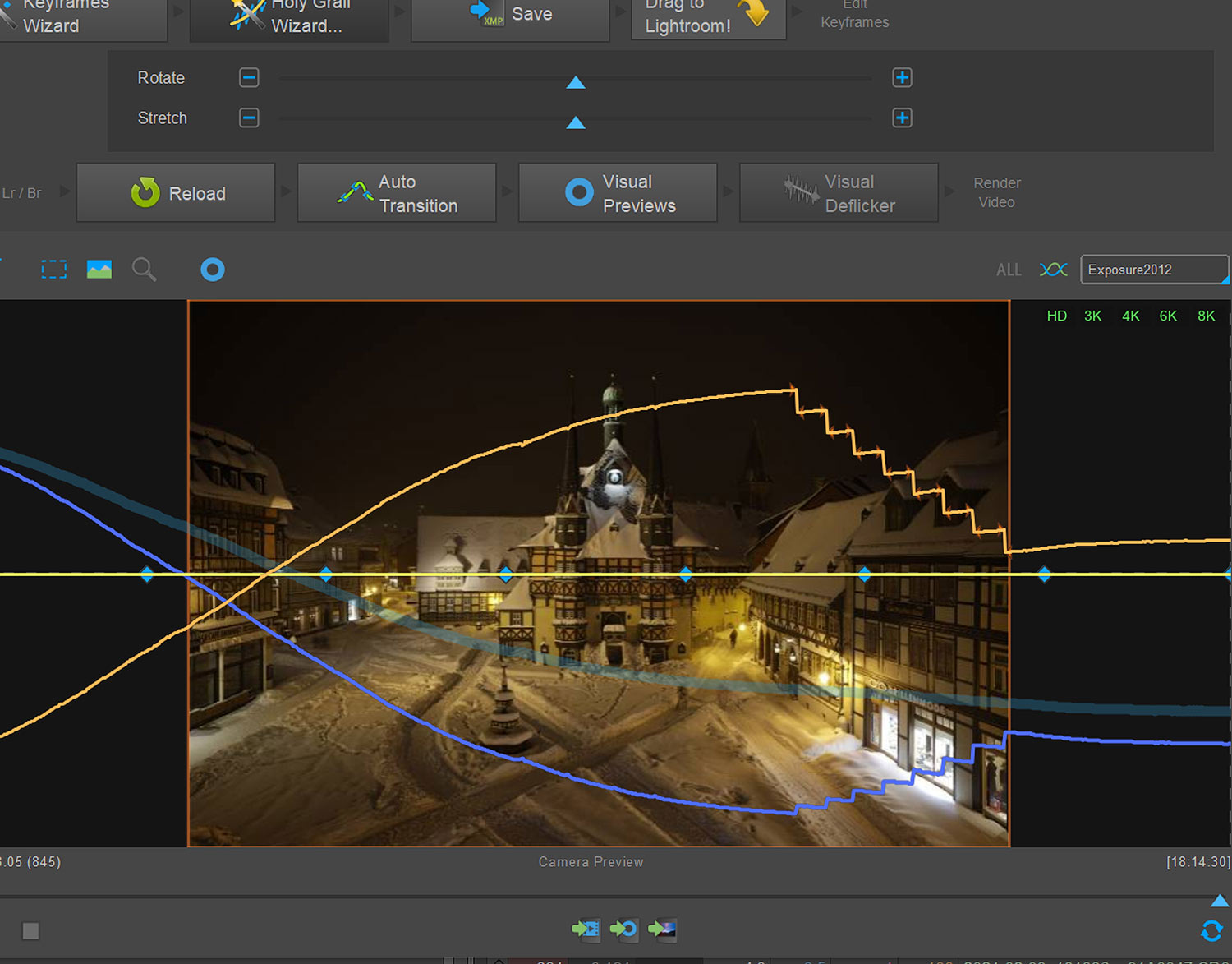

today I was shooting a blue hour-to-night transition using ControlMyCamera, iPhone 11 and R5.
Shooting interval 5", longest exposure set to 2", electronic shutter 1st curtain, using Canon TC-80N3 intervalometer.
Initial capture settings were 1/5, F4 and ISO 100 - slightly underexposed in order not to protect highlights.
Auto holy grail and NTC (2.0) were selected and I've started the sequence. After I've noticed images got too dark I have manually corrected the exposure on the camera (the + button in ControlMyCamera didn't react). Even though the sequence was underexposed around 2,5 stops at the end - the initial settings didn't change at all.
I've already successfully accomplished several holy grail transitions with the same setup so I'm really confused what happened.

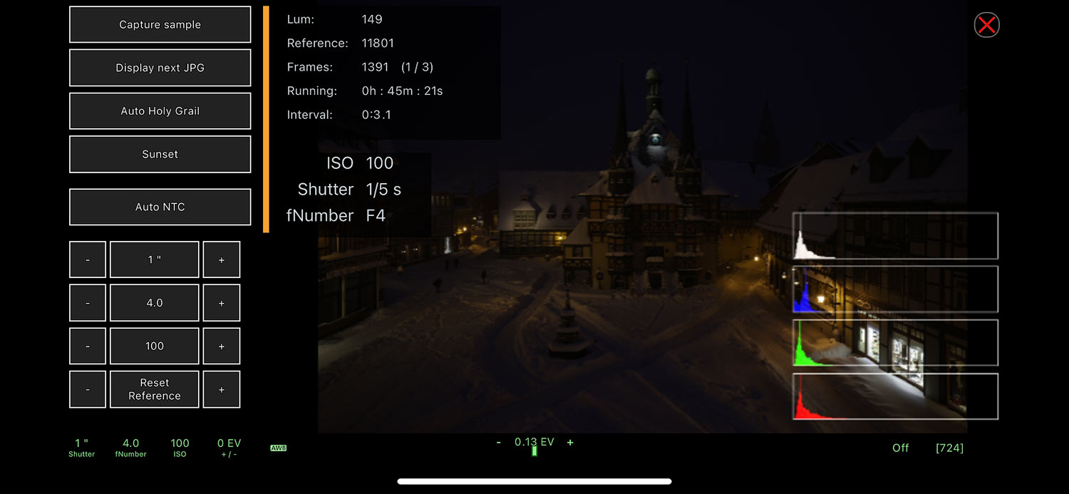

Please help, Auto Holy Grail results too dark

Re: Please help, Auto Holy Grail results too dark
According your last image the 'Auto holy grail' was not enabled.
Thank, it’s correct. I’ve taken this screenshot after going in full manual mode adjusting the camera by myself. Before that it was activated. I should have written that in my original post.
